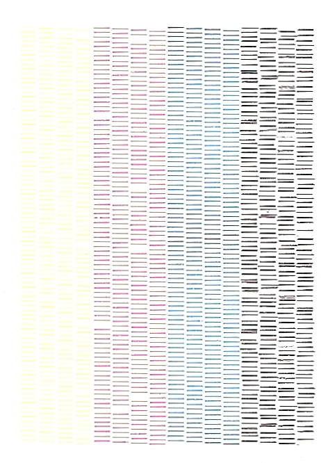

Thank you Bob for the advise.
I am attaching the "test print" that you asked for.
Not sure if this will help or not?
Thanks again!

Couple of things... first not sure if it's the scan or not, but there should be NO black on the magenta and cyan print.
Go to maintenance - cleaning - medium clean. DON'T use the heavy clean... just a waste of ink... run the medium, do a test print.. if it's still not good run medium clean again and run test print.
Let us know.
The nozzle test looks to exhibit cross contamination on all colors except yellow. That would account for the lack of gamut and color accuracy that you are describing. I would suggest:
1) Run a medium cleaning as suggested by Stacy.
2) Run nozzle test print to evaluate. Use a loupe to check for cross contamination on the K, C, and M channels. If it is present and cannot be cleared up with cleanings, the next step would be to replace the dampers and/or cap tops on the printer.
Bob

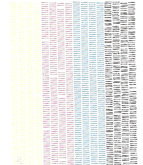

Stacy, It does look like there is some black color in the others. I never noticed it when looking at it but it does pick it up with the scan more.
I am doing more cleanings now to see what happens.
I did 3 more cleaning and I don't really notice it very much now.
I did do a print sample and still not looking right.
I had a tech guy help me change the ink set up to Eco Sol 4 max because originally it only said eco sol. He did this because when I was using versworks I didn't have very many media materials to pick from. After changing this I had a long list of medias to chose from. Do you think this would of changed any color setting profiles??
I am just trying to think what could of cause this to happen.
Maybe it is just black into the other colors. I can't really see it by eye now on the test print. What other way can I clean other than what I just did.
Bob... what is a loupe? Is that the big qtip?

If there's black in the other colors you have contamination of the inks...
keep cleaning if it's coming out.. you are running the contaminated ink out (I hope for your sake)
and a loupe is a magnifying glass
I am still seeing contamination in the Cyan and Magenta. Another thing to try is to print out solid rectangles of Cyan and Magenta with all color correction turned off (density control only in VW). This will only use those colors and save ink in the colors that do not appear to be contaminated (Black and Yellow).
Bob
fatdogvw
That test pattern has to many gaps. Try doing a manual cleaning with the swabs. Don't forget to clean the wipers. Also make sure that you installed the cartridges in the right order. If you still don't get a good test pattern you need to check the damper. Bad damper will effect the pressure and flow of ink to the head. Good Luck.
