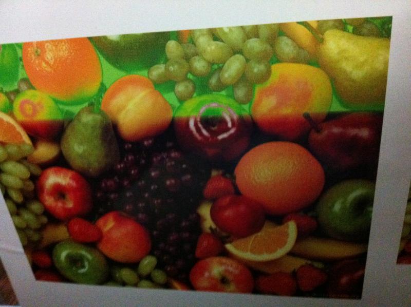

See photo of print with missing color after 12"-20" of print. Tried printing again but it happen on different spot. Not consistent on the same distance it varies. Memory maybe or any help would be appreciated.

I would do a print of 4 36" long boxes, 100% C, M, Y, K respectively. turn color correction off, and print it. see if only 1 or 2 colors start degrading at the magic 12-20" mark. if so, you have flowthrough issues on those colors. if they all stop/die it could still be flow issues, but it also could be the fact that you are daisy-chaining cables.
if you can, try pulling the machine closer to use just 1 cable and see if that works first.

Usually when memory is damaged or failing the print will just stop completely. In this case I would say you have a plumbing issue. I would double check your ink lines for any air that may be sneaking in and also check that when you run a cleaning, ink actually flows through your waste tubes. It looks like you revived the machine pretty well. You might just need a new oring for the black and/or have a defective damper.

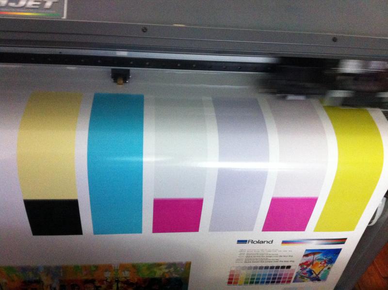

I tighten the damper connection and did 4x cleaning. I can see ink coming out from pump no problem. Did the test and still doing the same thing. Swap dampers and still the same. Tried printing CMYK in blocks and it shows that the complete head 1 stop printing (black, cyan, magenta). :banghead:

I actually watch the printer until print head 1 stop injecting ink. It didn't go to the capping station to do quick clean. But it just normal print but head 1 stops working. Once it started the problem cancel printing and see if there's ink on the damper and if i see visible air bubble on line. But no sign on Air leak. What do you mean captop? just replaced the capping station.

Thanks, I did the service fill test print already and it didn't show any color change. For it only print 1.5" horizontal strip per color. What I did now as per 3hill suggestion to make a blocks solid color and see what color missing. At first I thought that it stops firing until I see the block printout. It did not show miss firing but it change color from black to light yellow and magenta and Light magenta to CYAN. I'm hoping it's just the carriage board for its cheaper than Main board. Any thoughts of what the problem with the machine. Tnx

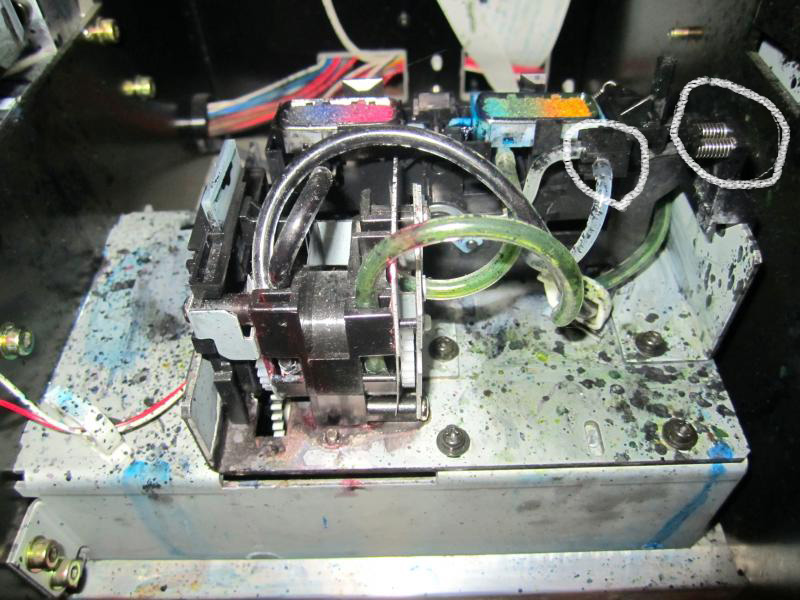

Next photo I pick it form thread here , the left mark piece have 2 tube each one connect to one cap , front this piece there is 2 holes when the carriage parking for cleaning it's move to the next mark part with 2 spring pushing well to close the 2 holes prevent air leaking so the pump drawing ink well .check that part for any thing wrong or broken , you can pull the 2 tube from left mark piece insert thing inside it to prevent leaking totally don't remove it from the cap.
