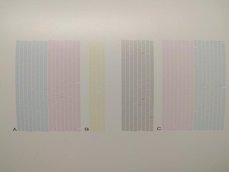

Thanks soo much.. I have another question.. My yellow is not working very well. Is there a way i can fix this?
niksagkram
Hi Daphany. Can you post a pic of your nozzle check print out?

daphany
attachment.php

It looks to me that possibly one of the following is the issue:
- 1 yellow cartridge is empty, or very near empty
- Clogged Damper on one side of the yellow head
- Clogged or damaged yellow captop/tubing/y connection
- Damaged Damper seal on one side of the yellow head
- Cracked Manifiold on the yellow head
- Bad ribbon cable feeding that side of the head
All kinds of good stuff.

Yes this was the initial issue. I noticed my reds were appearing pinkish so I was trying to find an option in the menu where I could possibly pump the colors through. The cartridges are full. I used a syringe to suck yellow into the dampers. It appears the lines are full with no gaps or clogs. Cap top appears to be ok. How can I tell if the there is a crack in the manifold or if its a bad ribbon cable feeding? Any thoughts on why the black ink is bleeding on the media? thanks so much for your reply:)

CAREFULLY move the left ribbon cable on the yellow head to the right position and print.... FIRST - POWER OFF, UNPLUG, GET A CUP OF COFFEE, DRINK IT, THEN VERIFY THE UNIT IS UNPLUGGED AND OFF BEFORE REMOVING ANY RIBBON CABLE....
You can also switch the damper lines on each side of the yellow head to confirm a flow issue or not.

Pull the line from the pump and see if you can pull ink through the whole system. if you get ink, do a test print and open cover when it goes over material first time, then put some cleaning solution to the cap top close the cover and do a normal clean. if you start getting it back do a couple more normal cleans and it may come back completely. also a low ink cartridge at any time may have put air in the lines and sucking ink through the line will clear it up.
i have also had the cap top dislodge and was only making contact with half the head.
