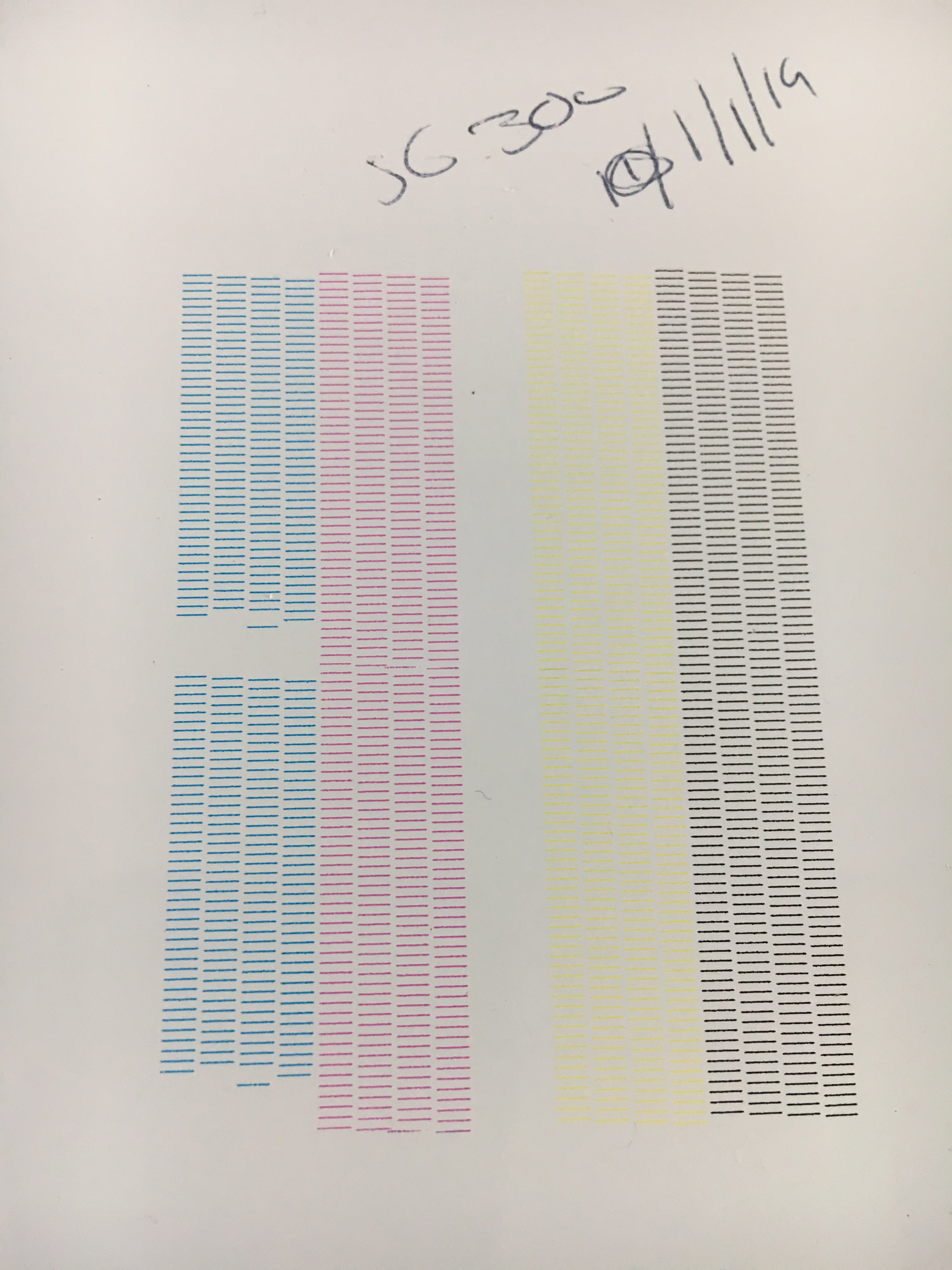

I replaced the head on my SG-300 within the last year. I came in after one day and the blue had run out. I've attached the print test. I've soaked the head, replaced the cap and done a Med cleaning as well as lightly pressed a soaked swab again the print head. - Thoughts?
