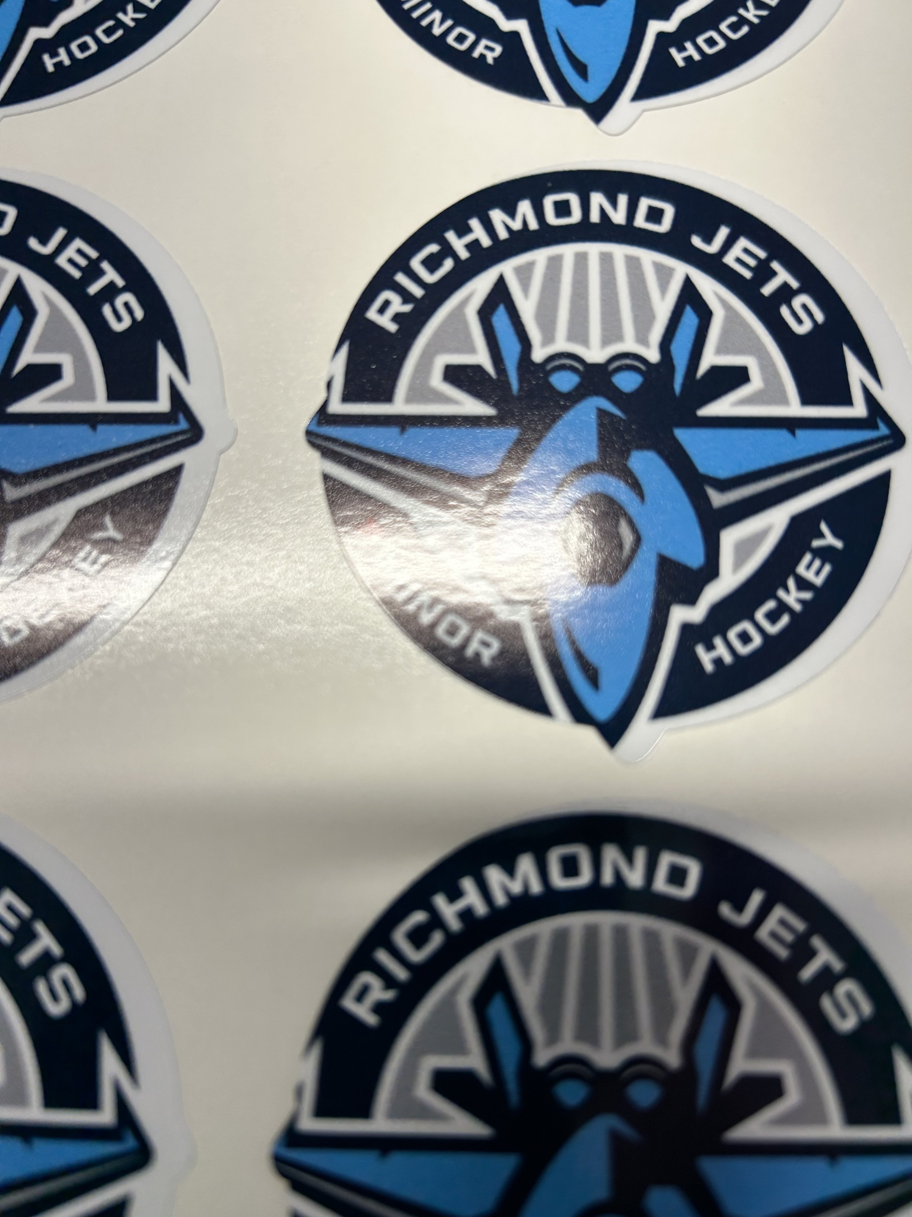

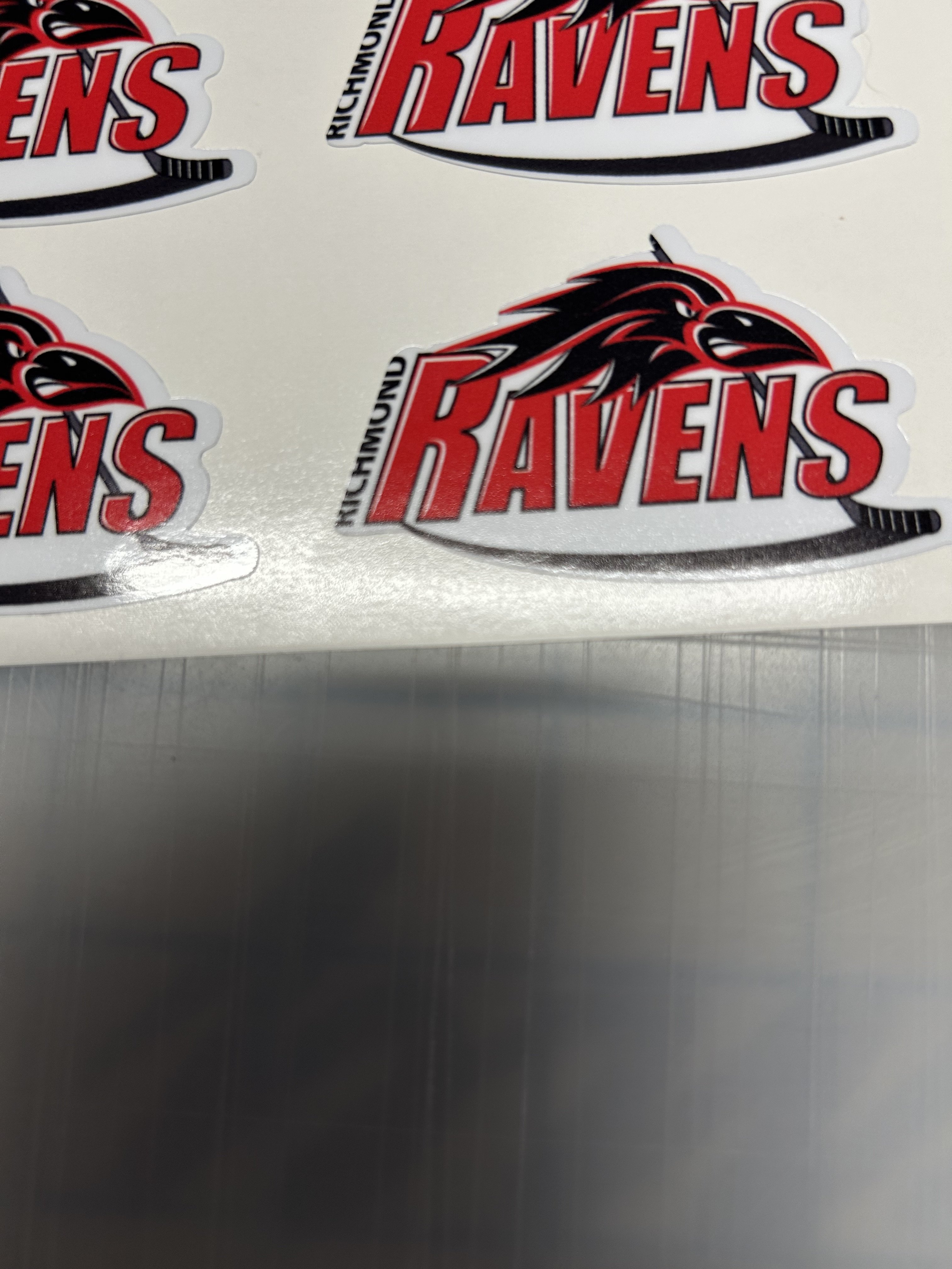

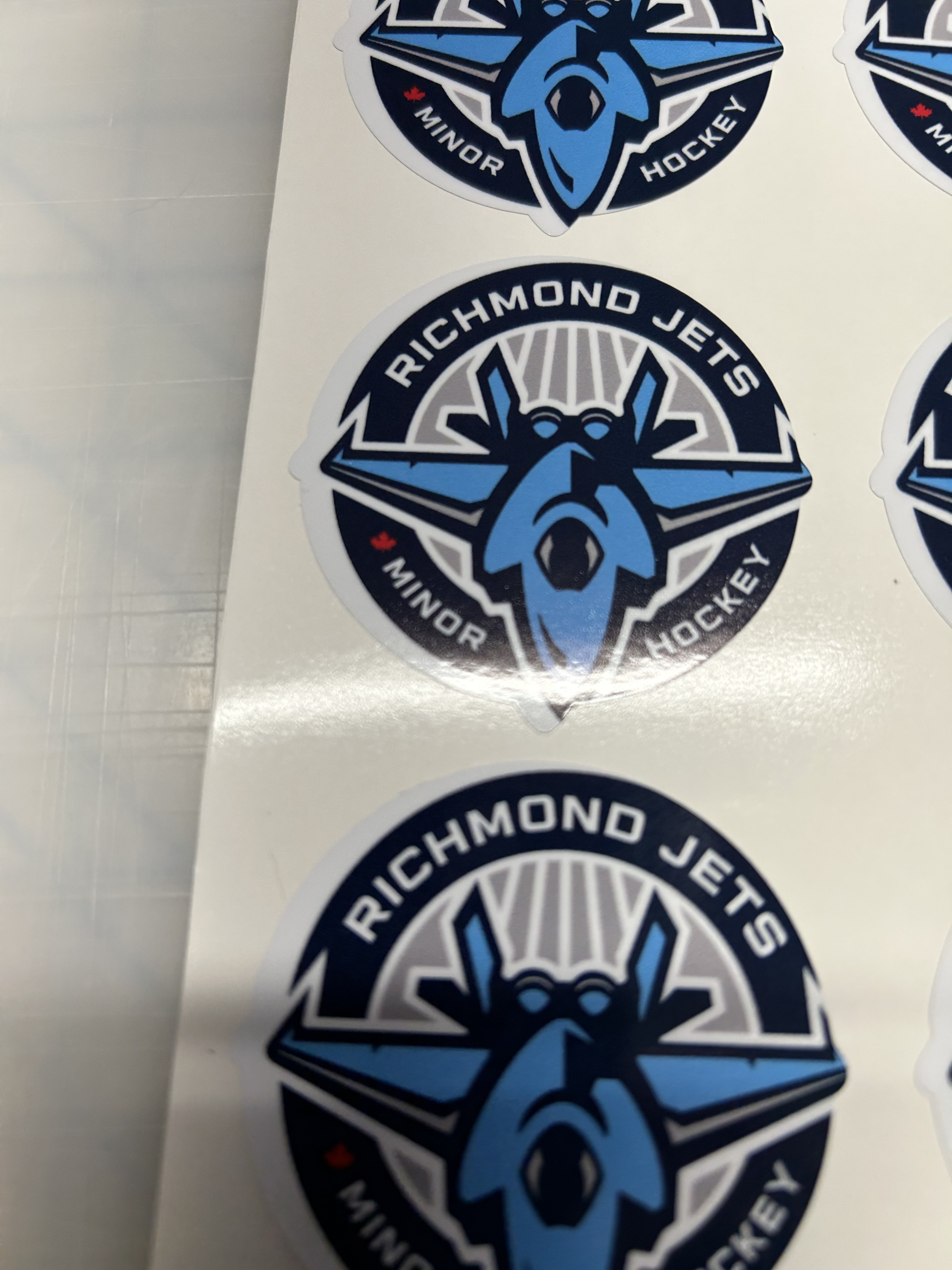

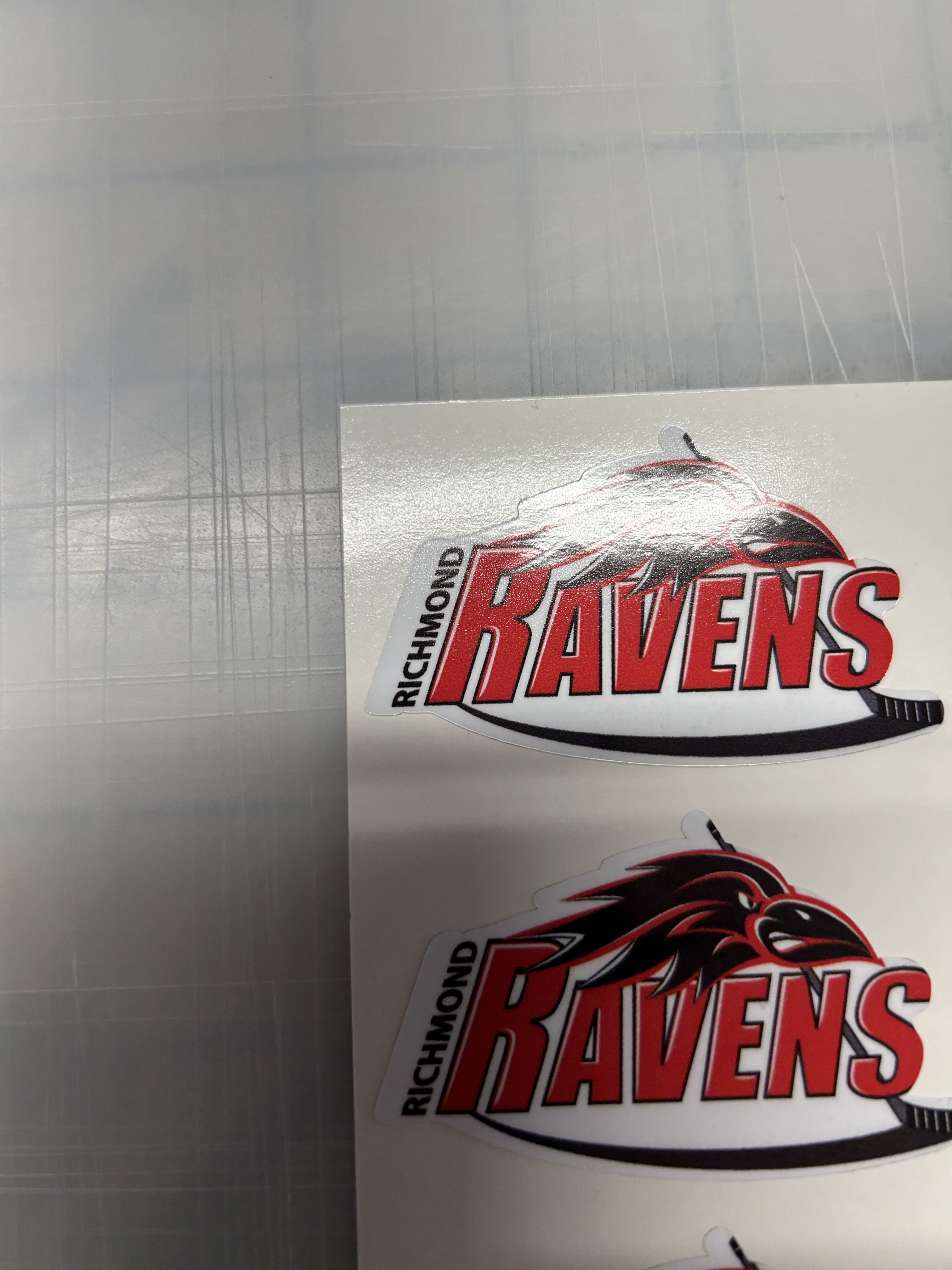

We have a 54" Roland Verscam that is about 12 years old. Our problem is when we print, lam and then CAD cut decals, they tend to skew a lot. We are not sure if it's a heat issue from the dryer that may be causing the material to stretch and then shrink (we tried turning the heat down, turning the heat right off, etc. etc.) but the cutting tends to walk on us. Anyone else have this issue, or recommend another way of achieving a more accurate cut? We are printing onto Hexis gloss and laminating with an Arlon gloss film (both calendared). Thank you in advance for your suggestions - we have had to redo this order twice and are getting nowhere fast :(

On another note, I was running some QEP today (which is only about 30" wide) and the temperature on the right side of that metal piece that the material feeds out onto feels much hotter than the left side, so I'm not wondering if possibly the material may be stretching more on one side than the other. Although I have tried printing these pieces without heat, and they still gave me issues. The cutting is acceptable when it's just a print and cut, but when I Print, Lam and Cut is where I'm having the biggest issues, and of course, I have several projects like this that are due at the beginning of next week F.M.L... it's always something, isn't it!
