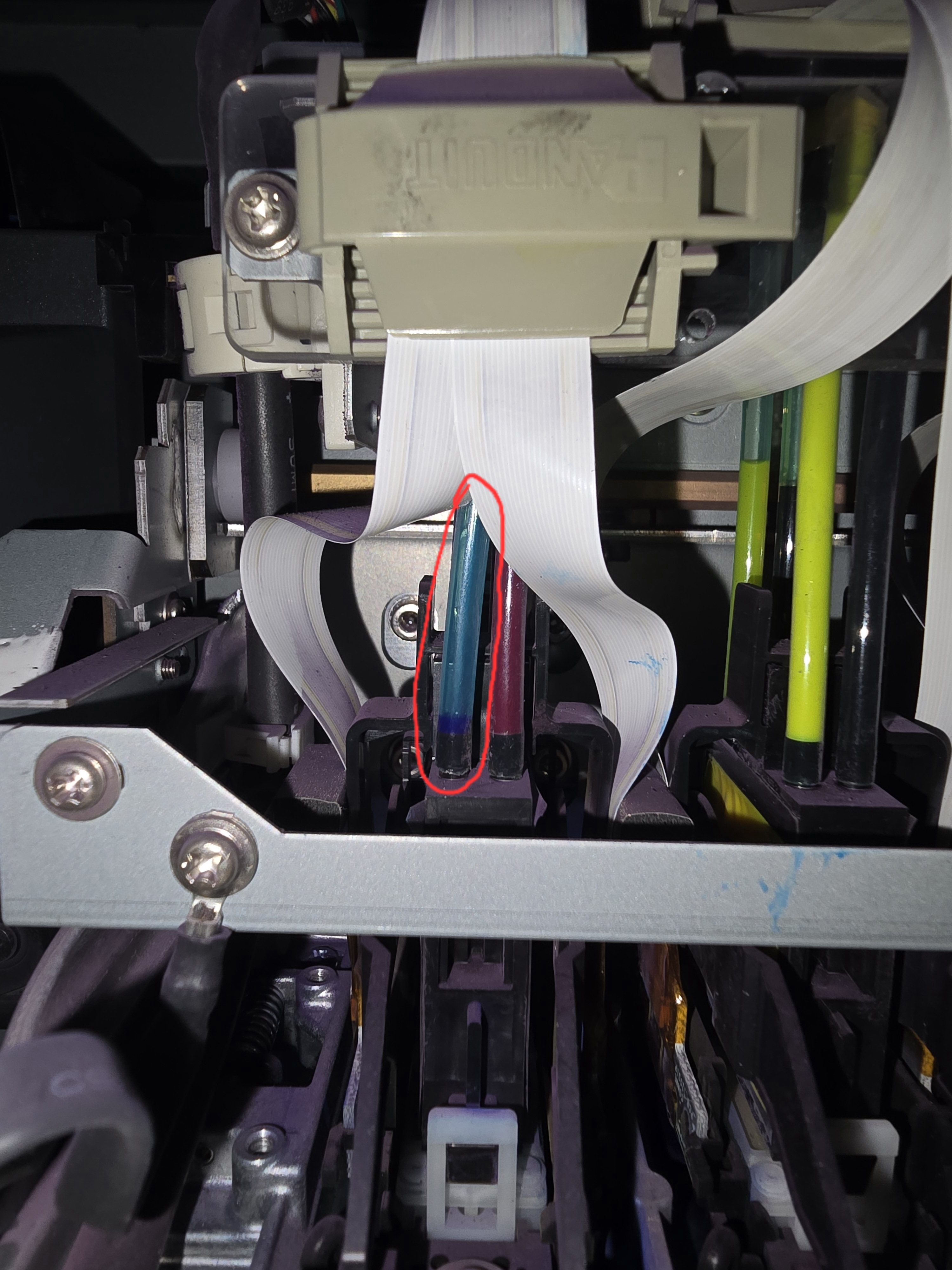

With tons of workload Roland vg640 was printing fine yesterday but now my printer decided not printing the Cyan on Head A
I tried to powerful cleaning and manual but wont work , the test printing show its normal on Head B but no Cyan at all for head A
Open the head and see there's no ink pumping into the cyan tube
Tried to contact Roland technician but need to wait them for a month :(
Im crazy with 200m need to be printed next week so any can help me out this.
Please find attached for test print
Its been replaced mainboard and captop last 3 months
I cant attach photo, error site
Please find the link https://postimg.cc/gLYnhYDK

OK you are getting air into the line somewhere which is stopping the damper and head filling. The tube should be full of ink like the other ones. First check the ink hasn't actually run out, if not, you need to inspect the line and all connections from the cartridge dock to the damper to find out why it is not filling

Hi mate. I cheaked all the lines and theres no leaking or something
I did try do 5 x powerfull cleaning and now the ink back to full tube and then i tried to test print and comes out few cyan line on head A only
Im doing soak head overnight and will see
Do you thibk its captop problem, due to i did see the other 3 lines are full ink which is same captop but only Cyan not at all
What you reckon ?
damonCA21
It is unlikely to be the captop and only effect the cyan. If it was it would most likely also effect the magenta next to it. There is a reason the cyan ink wasn't filling the tube and you need to find out why that was.
If the tube is now full, don't do a head soak as that wont achieve anything as the head won't be blocked after just one day.
Make up some artwork with 10cm bands of cyan the full width of the vinyl and print those out and see if it gets the ink running back through the head.

Had the same exact problem. Replaced the damper yesterday. So far so good. You do need that fat serynge to manually suck ink to fill the back lines that have the caps at the end. Suction, fill, pinch , put cap back on.

I raised this problem before but after few cleanings and printing cyan only , it pumped the cyan to the head but now im facing same issue and tried to celaning and print cyan but not working at all
Just Replaced the damper but seems its not pumping the cyan into the tube
How did you fix this ? I tried to use syringe pump cyan ink to but its suction and cant pump it
Also the took off the tube near the cartridge and no ink going thru from the cartridge. Theres small round container with plastic on top , i saw there's no ink inside as well
Im gettinf nuts with this , having big job 30m sav print and most of color are cyan. Lol
Find the attached photos mate.
Appreciate your help
