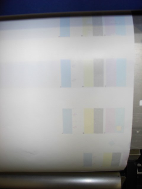

ok, she just send me a print test. The picture is not very good but what would you call?

Yeah, Magenta is usually the first to dry up when left for a while. A good clean / perhaps syringe and captop should get it going. otherwise looks quite good.
