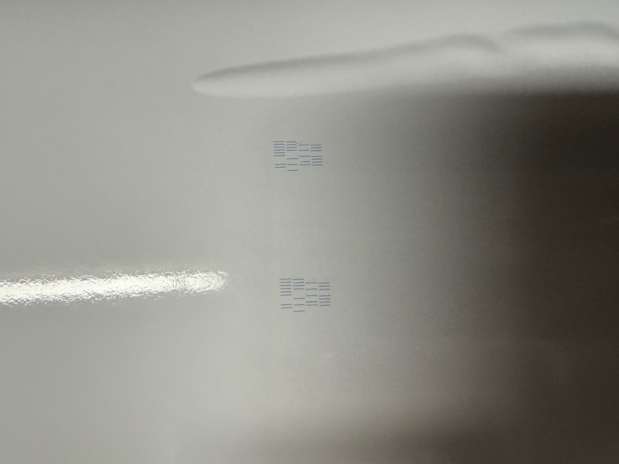

So the this printer has been unused for a couple of years and here is the "story" so far:
Have divided this in 2 because of the attachment limits. Question in the end of the 2nd thread.
March:
Started up the printer ran powerful cleaning and normal cleaning. Did a testprint and this was the result: Few shots with cyan

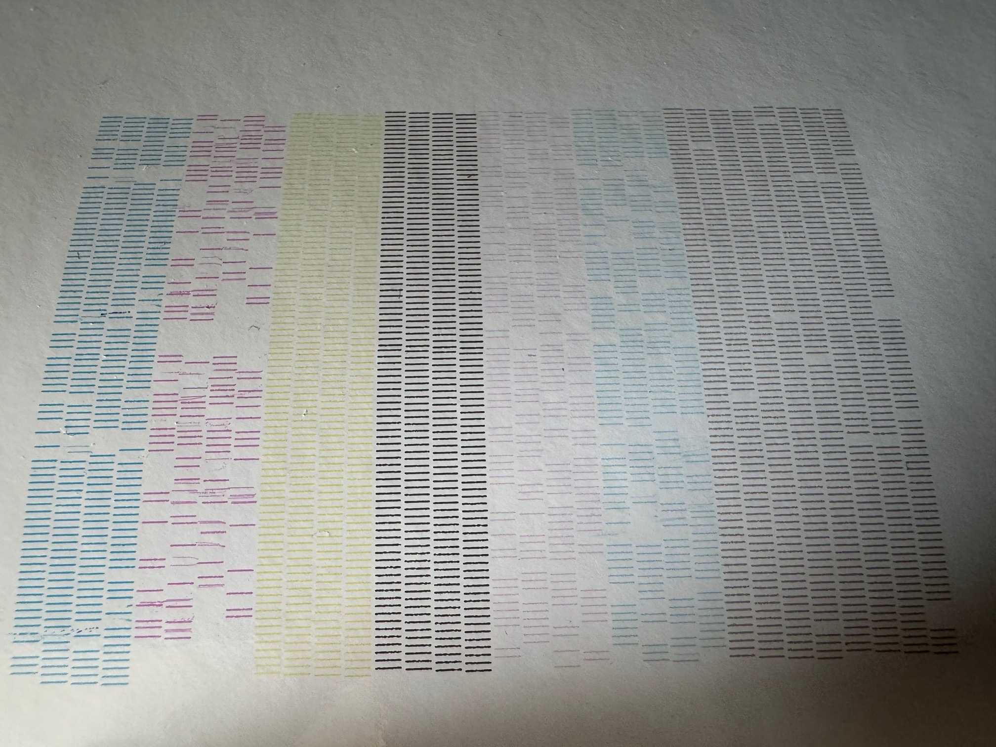

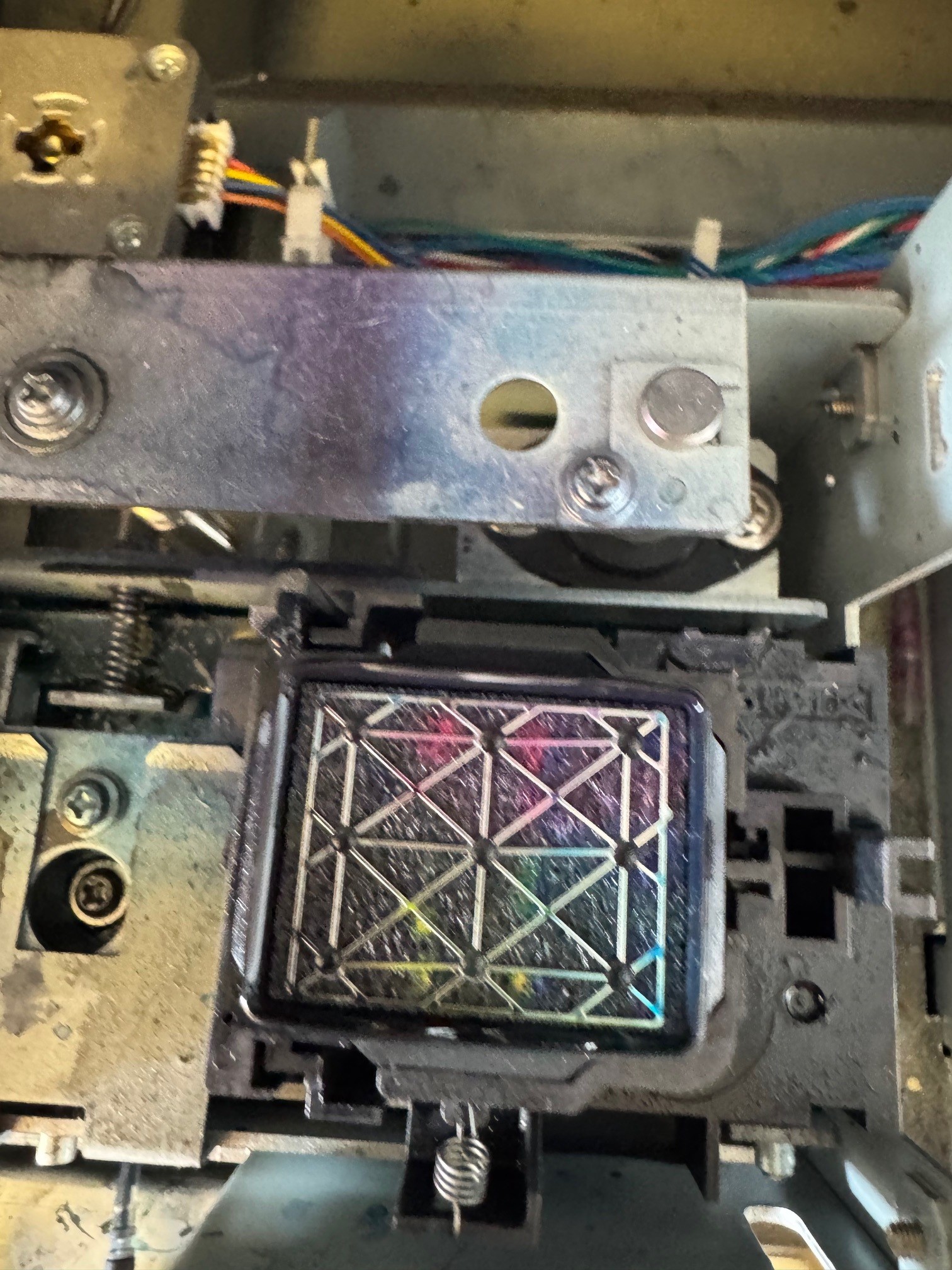

Did some more cleaning, did a headsoak (Cap down filled with cleaning liquid, cap up, plugged the exit hoses cap up, over night)
Result: Cyan, Light Cyan, some black and yellow, nothing on printhead B yet

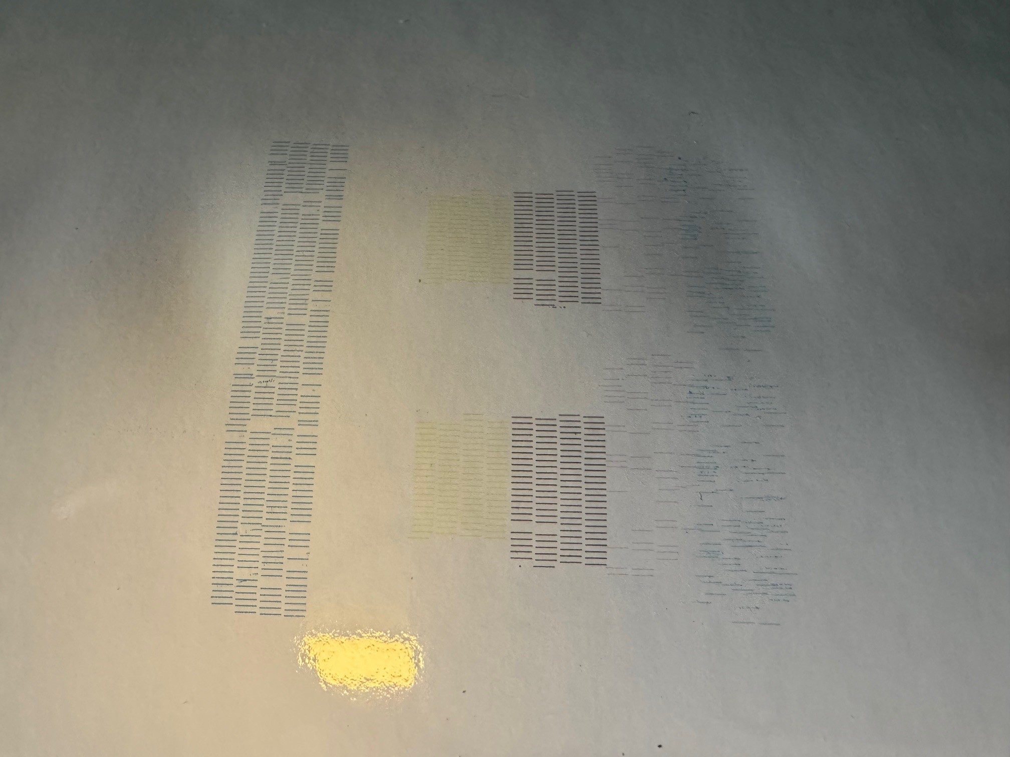

Ran some more cleaning and a Choke CL.
Results: light magenta woke upp and some additonal lines on the others.

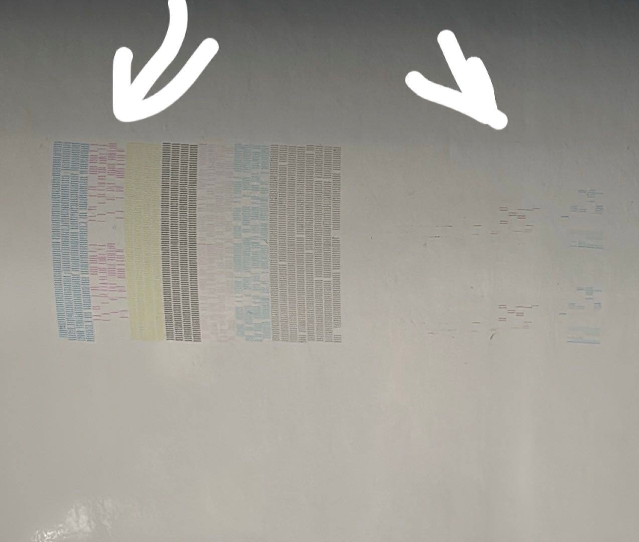

Did some more cleaning, did a new headsoak and forgot to plug the exit hoses so I basically drained all my cartridges.

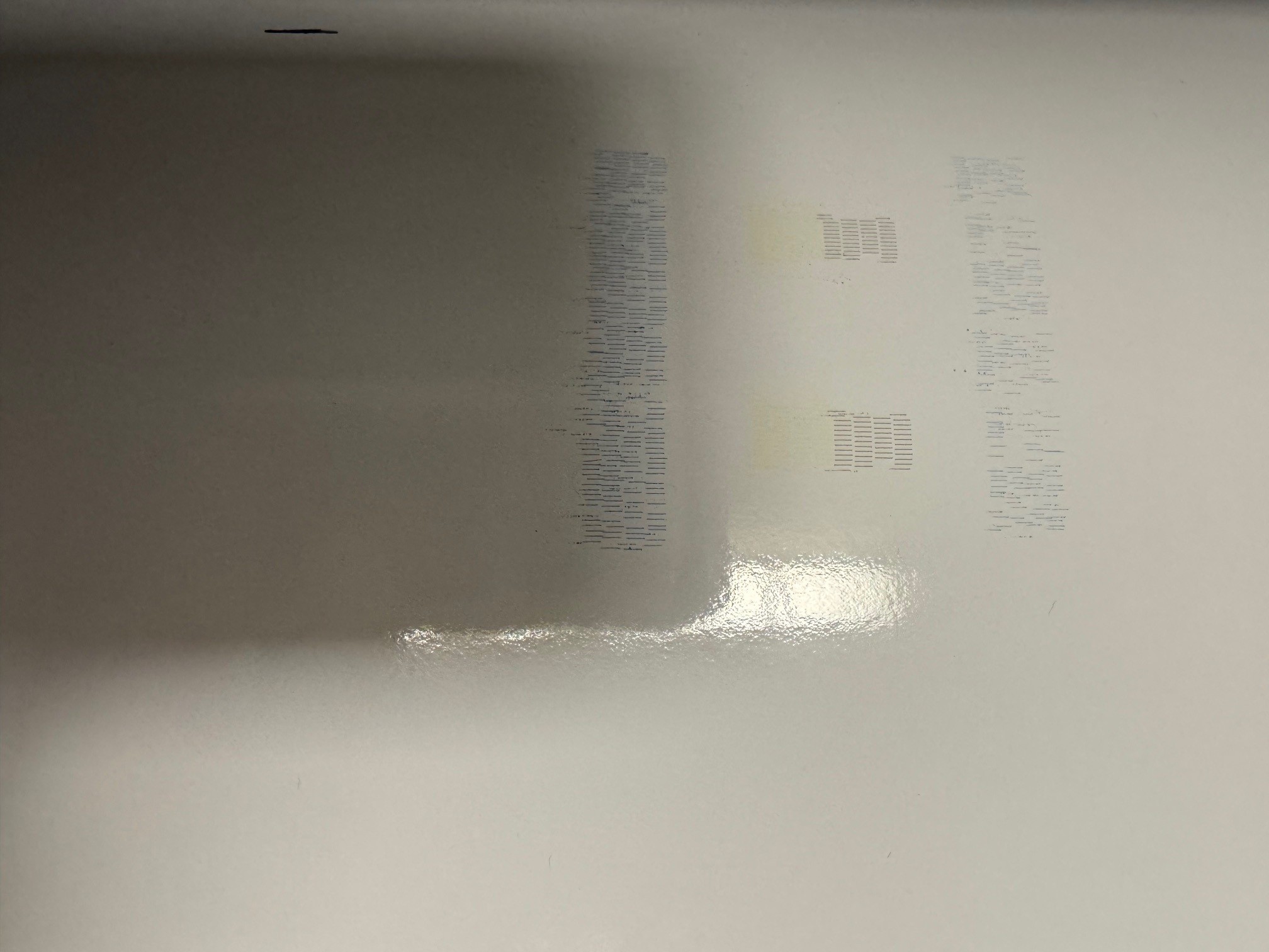

Results: (apart from anger) Head A looking alot better, all colors represented with few magenta shots. Head B, ITS ALIVE! Got some magenta, light cyan and cyan,
did some a headwash and ran another choke clean.
Results: more magenta on Head A and other colors looking better som mixed result on Head B.
