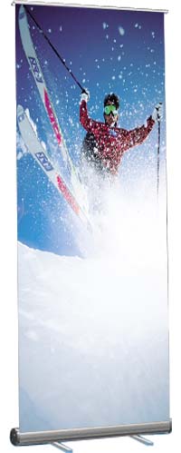

What material do you use for these Roll-ups?
i usually use banner, but if print is full colored, it bends on edges...
thanks...

Polyprop satin film 180 g/m2, edges are straight. Try to call TEPEDE or FORTUNA KOMERS in Croatia.
jmcnicoll
I would not recommend any vinyl banner material for a retractable banner stand. We use lexjets display film on our aqueous printer and then hot lam it with a 5 mil texture on top and a 3 mil gloss on back. The poly, fellers pop up and similar items work well too, they print great but in most cases don't take the abuse customers give them.

thanks for ideas. I guess i will have to look for some more materials!
i have notice, that sometimes when roll-up is inside, often is used photo-paper! What about photo-paper 220g? do you think it will roll nicely?
