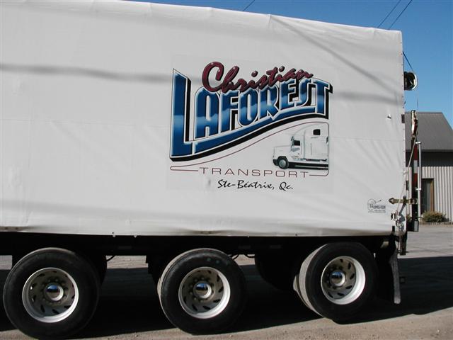

'Done this retractable tarpaulin trailer 2 years ago using 3M IJ180. Print was about 52" x 72".
The guy knew it was "beta testing" from the start. He told me it last few months but soon began to crack everywhere. 'Must mention we live up north which means the temperature can go from -40°C to +40°C and tarpaulin was rolled back & forth few times / day. The best thing is getting it painted or printed directly onto it.
