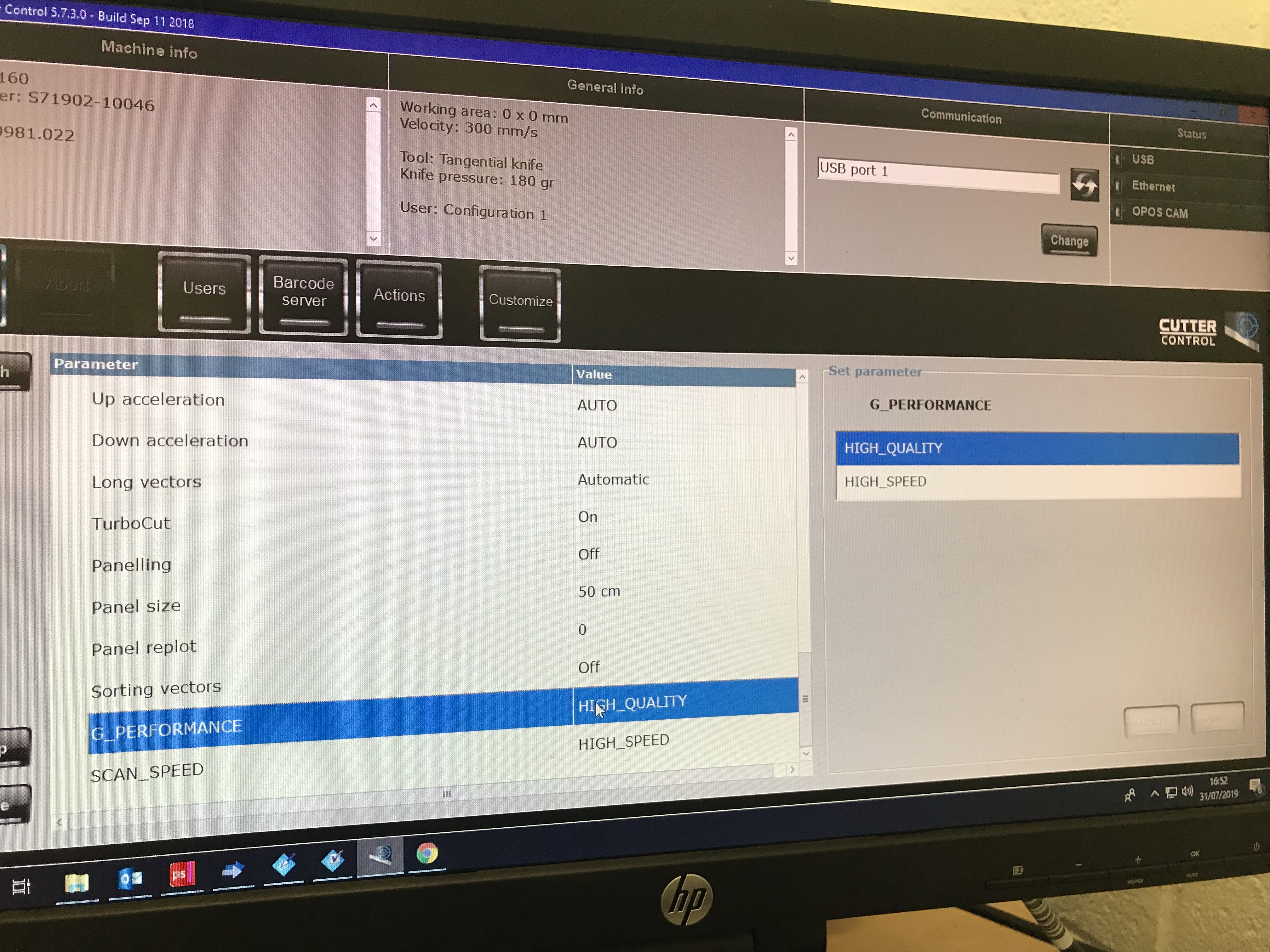

With it activated;
there’s an option for selecting mark registration in the summa cutter control. You can either choose high quality or high speed.
Same with cut speed, there’s “high quality” or “high speed”. Haven’t really played around with it yet, though.

It increases the scan speed, and on the cutting, it also increases the acceleration of the motors from what we have found.
