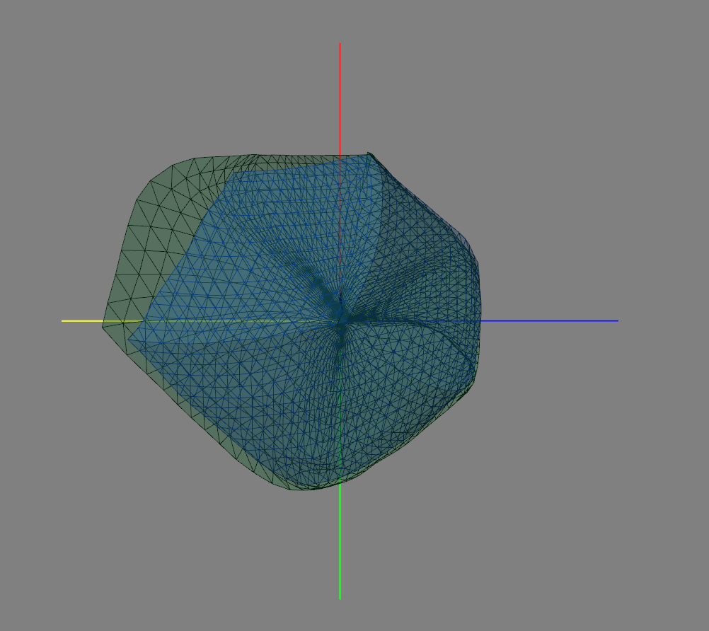

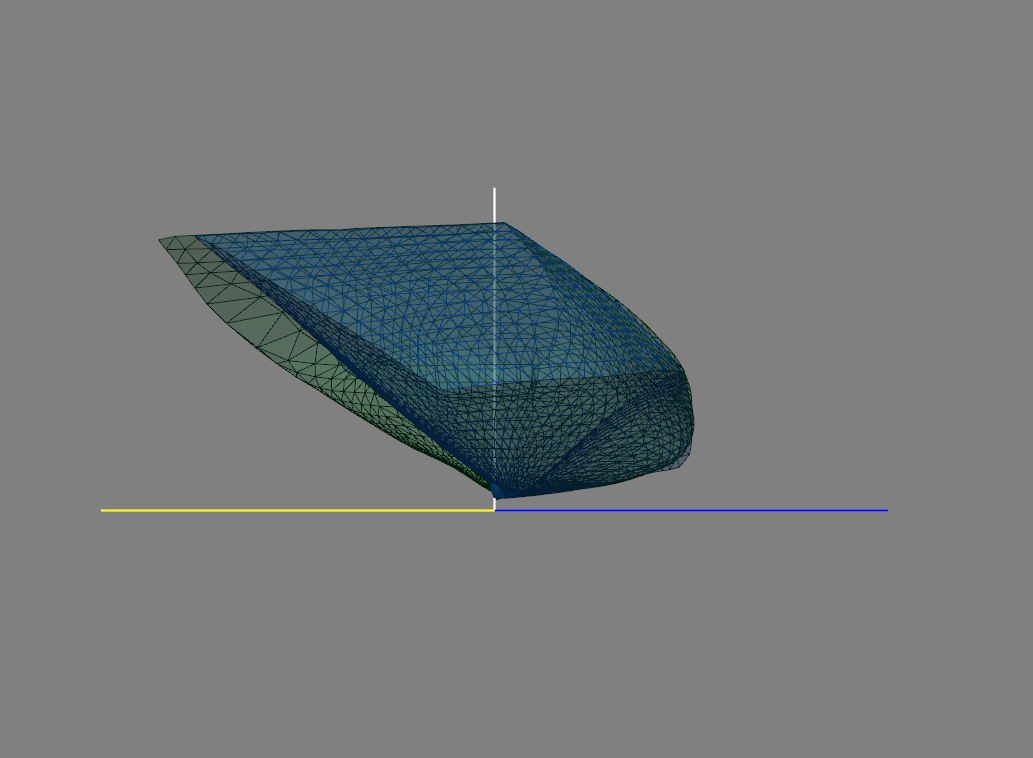

Here are a couple of plots I did showing the gamut difference between CMYK and CMYKOR from our S80600. (Light CMK shouldn't expand the gamut, they're only there to reduce grain/stepping).
Pretty visible how the oranges are so much better represented. Reds, not as much as expected.
If you can live without hitting Pantone 021C, the S40 will provide ample gamut for most jobs.
