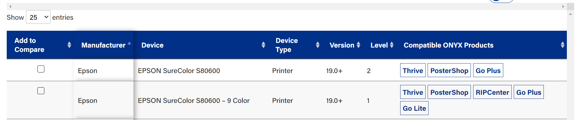

S80600 -9 Color in Onyx
Boudica
I'm not sure there is a difference, other than the number of compatible Onyx products (based on your screen shot).

Choose the first one.
Picking "9-colors" locks you out of ever using the white/silver channel. You can go back and forth with the first one, but not 9-colors. Ask me how I know... You can change it later, but at the expense of settings/profiles not rolling over.
I ran for about a year using the first one, but once I decided I wanted to try white, the printer wouldn't allow it because I had initially chosen 9-color. Ink/Silver would be the 10th channel.
Thank you!
