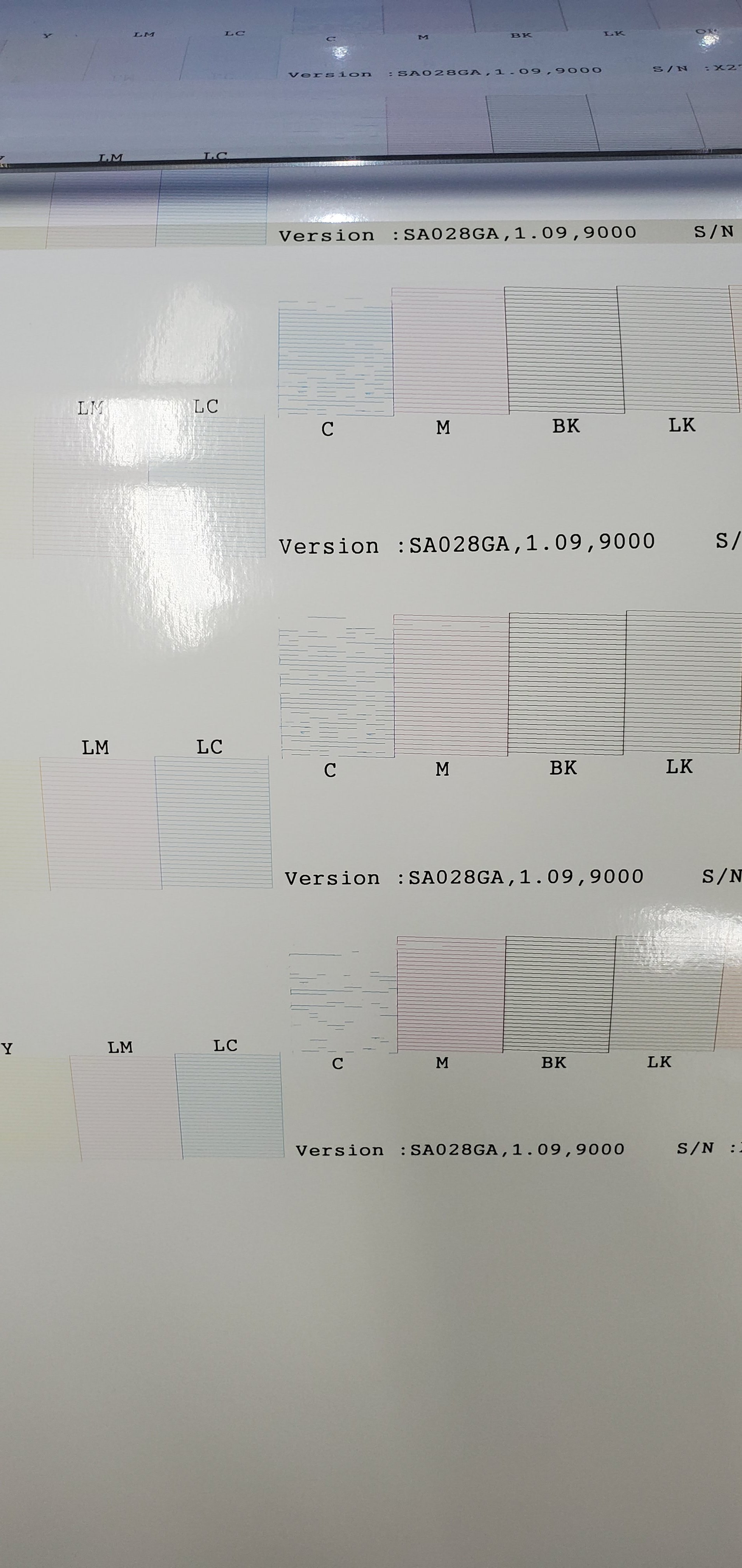

I came back from vacation this week and noticed that I was missing about 90% of the nozzles in the cyan nozzle of head 2, i ran a medium cleaning and it came back to around 70%, I ran a bunch of other cleanings and it made no improvement, I did a nozzle wash/flush on that colour block and it actually made it worse.
I've attached a photo of my nozzle test prints, everything else is 100% perfect.
We had a tech out in January to replace the cap tops, my gut is telling me we aren't getting a good seal on that particular colour, when I come in in the morning the nozzles are almost completly gone, after a few leanings it comes back to what you see here, but never gets any better.

try fire the cyan color printing large cyan square, clean your station to be as clean as a new one, use strong cleaning only on cyan head it can sometime takes time to fire a color properly, manual clean your head too, unload your cartdrive shake it has you can maybe replace it with another one if all the previus actions haven't worked.
