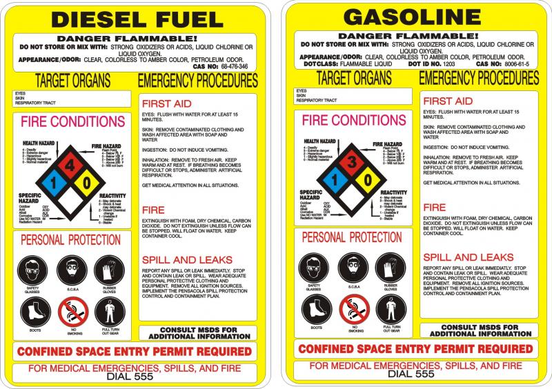

sometime you have to build em.......i searched everywhere for these osha compliant fuels signs.........had to build em from one of the old faded ones...
