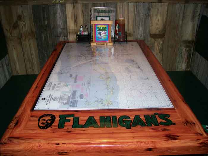

place lettering on floor and scuff it up with scotchpad it sould be fine. We have done decals used on bar tops and basketball courts without problems
Richard G

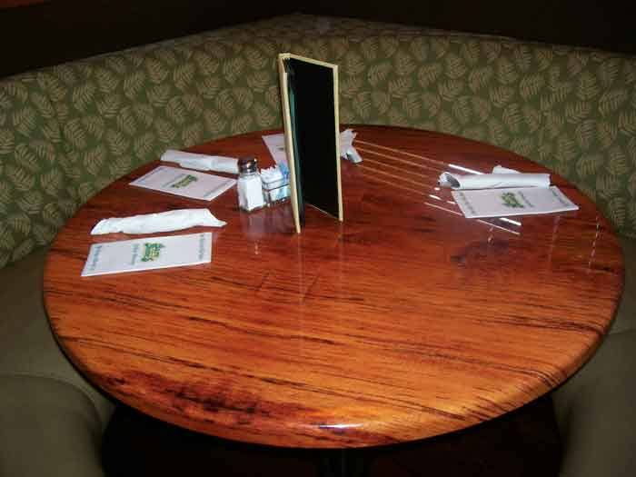

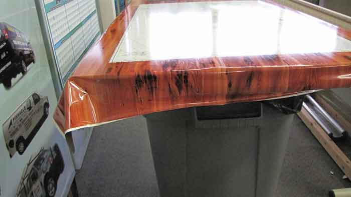

We have done some tables in the past and covered with epoxy. We do scuff the surface, but if table is really abused it will fail. these were done in Jan of 05 and are still out there looking good. The wood is also vinyl.

I did a dozen table tops, no laminate. Used PPG. Light coats at first till it tacked up, then heavy coats afterwards.
