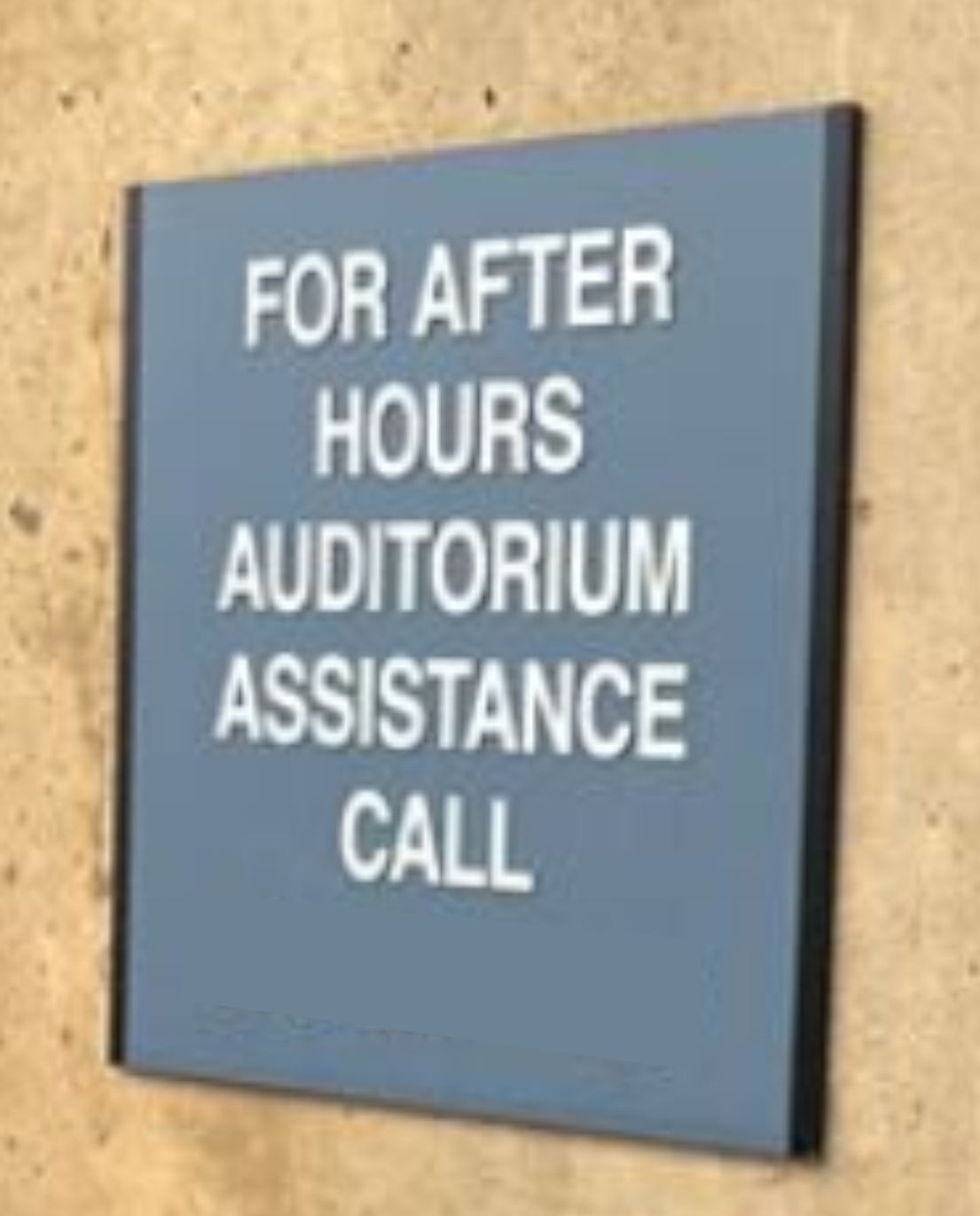

Hello. I am trying to find the correct name for this kind of sign. It is outdoors. I'm assuming it is plastic. The letters are plastic and are slightly raised. I need to source a couple of these out but I don't know what to call these signs or where to look for a vendor. Any help would be appreciated!

Those are ADA Tactile letters.
Those can be printed, with the right printer, or cut with router.
Usually paired with braille.
Look for ADA Tactile and you will find all the vendors you want.

yeah that looks like an acrylic sign with ADA lettering. We use our laser to cut them. Lots of folks with lasers or rotary engravers will have braille attachments to put on the braille.
