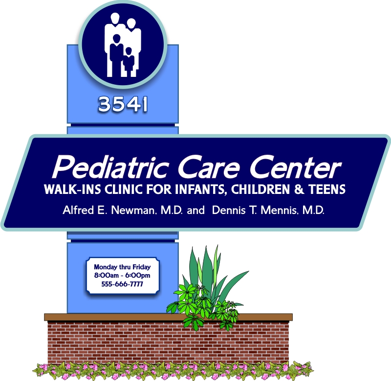

I'll get it started... 38 minutes done in CorelDraw X3 I used PhotoPaint and Alien effects textures to do the brick base. Tried to keep with kid friendly color scheme.
p3
I like it, and I like that its not all symetrical. The only thing that really doesn't float my boat is the hours and phone number. I don't think that necessarily needs the number and stuff since its a "walk in" clinic. lol I guess its just a made up deal, but seems like that info would be on the door or something.

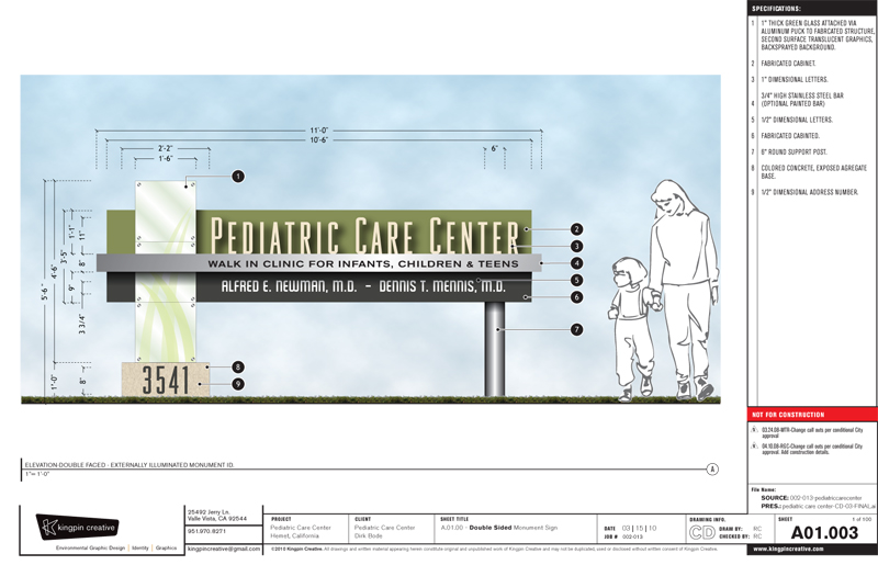

Reality would be...
Review Sign Code and Master Sign program - 1.0 hours
Review Survey and architecture - .5 - 1.0 hours
Logo and supporting materials - .5 - 1.0 hours
Design in presentation form for client review - 1.0 - 2.0 hours
This sign is a rejected design, so it took about 30 minutes in Illustrator W/CadTools

Nice design Rick, you ever think about writing a book :) I'm sure happy I don't often have to deal with all that reality stuff!

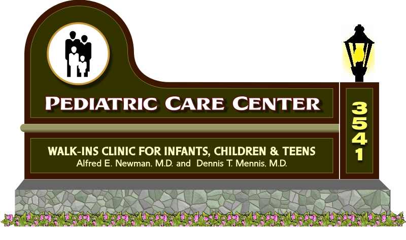

I whipped up one more just to show how diverse the designs can run... This one also took about 30 minutes. Funny but when you're in the zone, the designs just appear out of thin air!
SignManiac
I apologize. I just went back and made a one minute tweak...changed the base to stone. My one fault is I'm never satisfied...

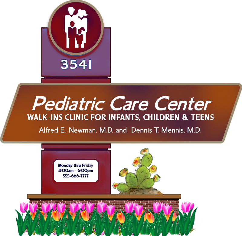

Hummmm..... I think somebody was watching me.
I did this in four and a half minutes. Photoshop without using clone tools, erasers or paint brushes. I was inspired by years of looking over shoulders................. :rock-n-roll:

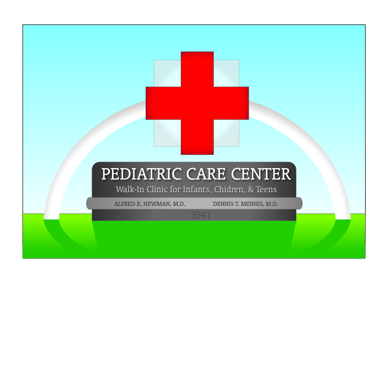

Shapes, gradients, etc.. in Signlab, made presentable in photoshop.. maybe 40 minutes of actual work.

OMGSIDEBURNS - I like the idea on yours. Maybe change the red tho. Looks a lot like an emergency room rather than a walk in clinic lol. Ambulances racing to the actual hospital may turn in.
SignManiac - Like the second rendition a lot better. I like the colors along with the older style light, like colonial, you have on it.
