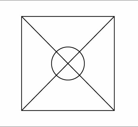

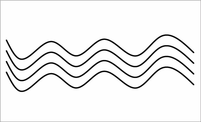

Something squiggly, and difficult to re-align....better yet, perhaps a series of squiggly lines.
Before the days of bar codes, merchandise used to have price tags with a criss-cross pattern that was intended to thwart tag swapping.
JB

They are intended to last up to a year outdoors. Removable but not reusuable. Thanks for the tips on patterns. I think wavy might be the way to go.
