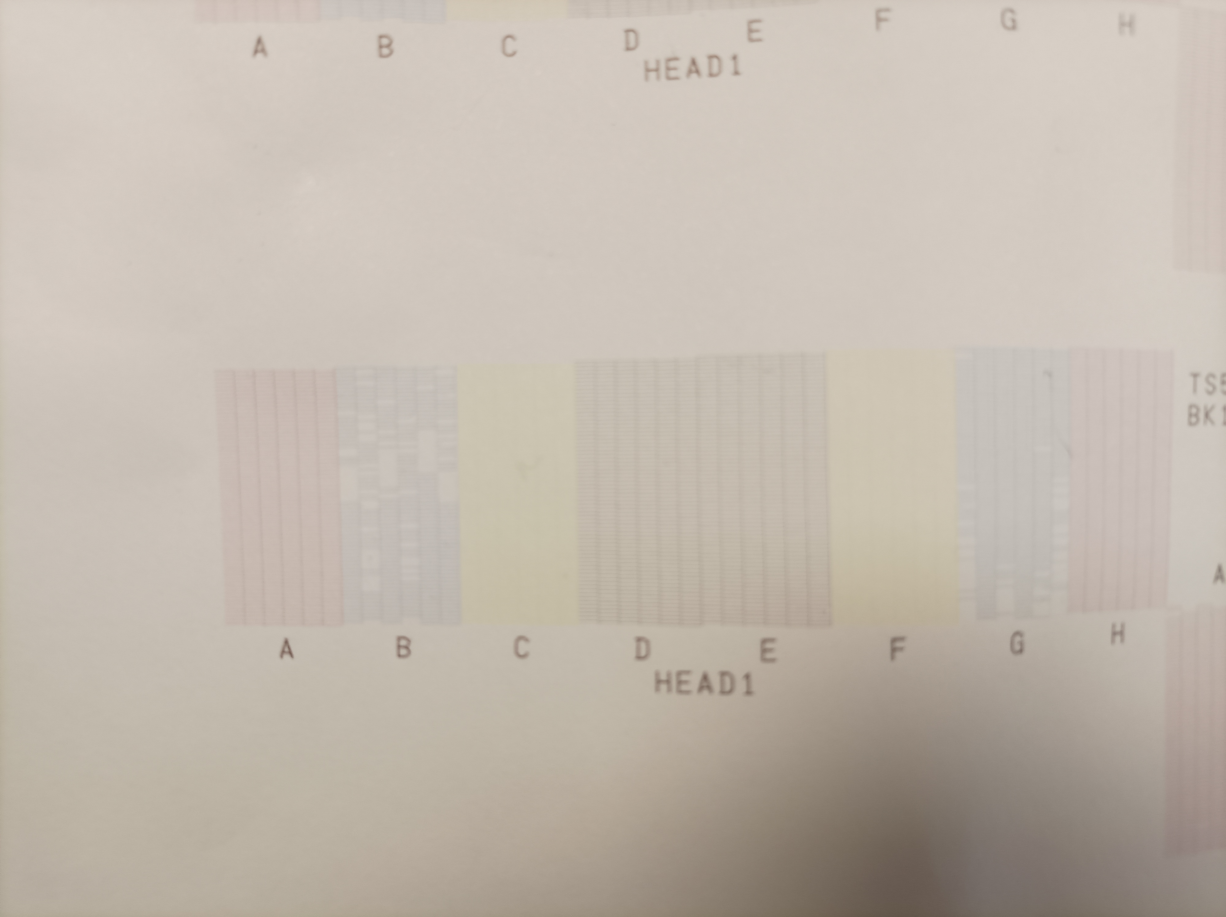

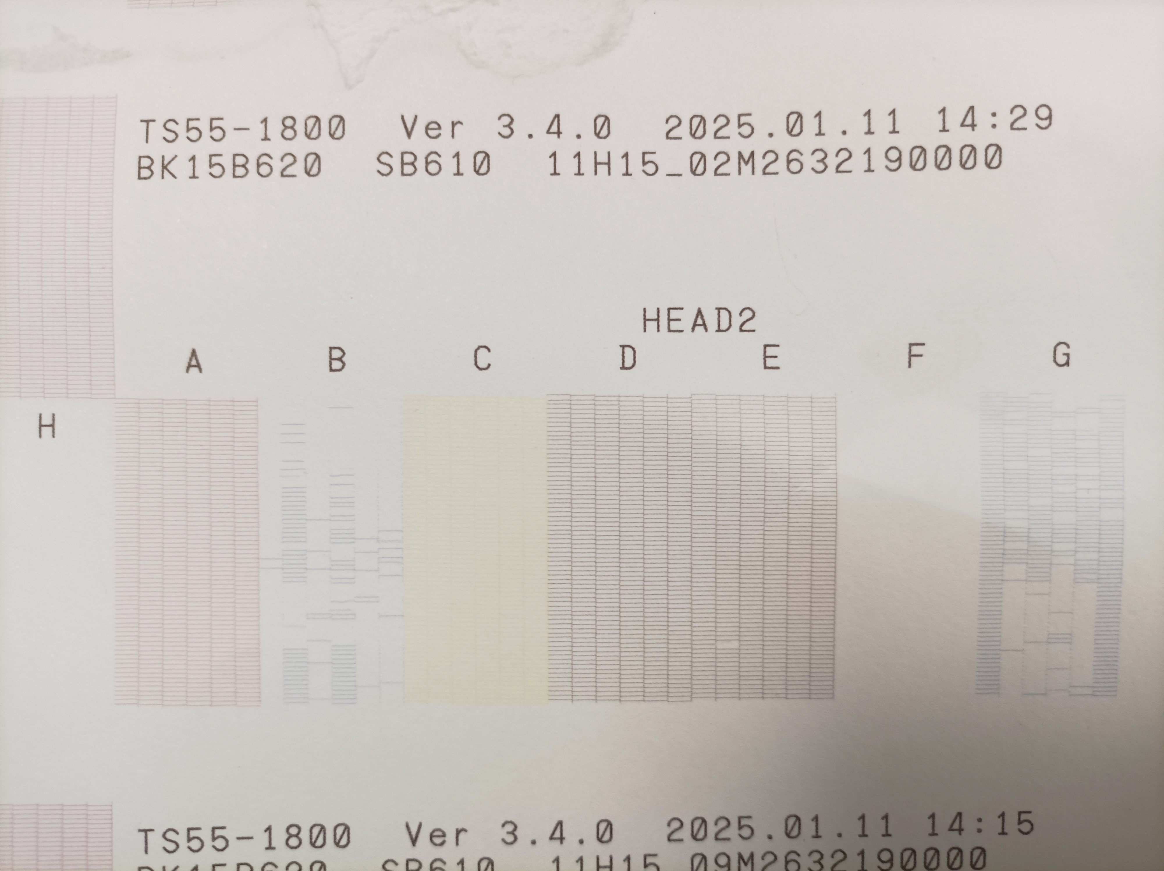

How does the nozzle check look like? If I remember correctly those can have issues with the head cables.
Here attached is the testprint - in this the yellow is also missing from head 2 but this is because of cleaning and comes back. But the blue has looked the same now for a while. In the beginning we received 10-20 blue nozzles back after each nozzle wash.

Yeah, if a syringe flush didn't fix it, new head is probably name of the game there. Could probably cut the bill in half if you were comfortable with doing a head swap, but I'd have to side with the diagnosis.
