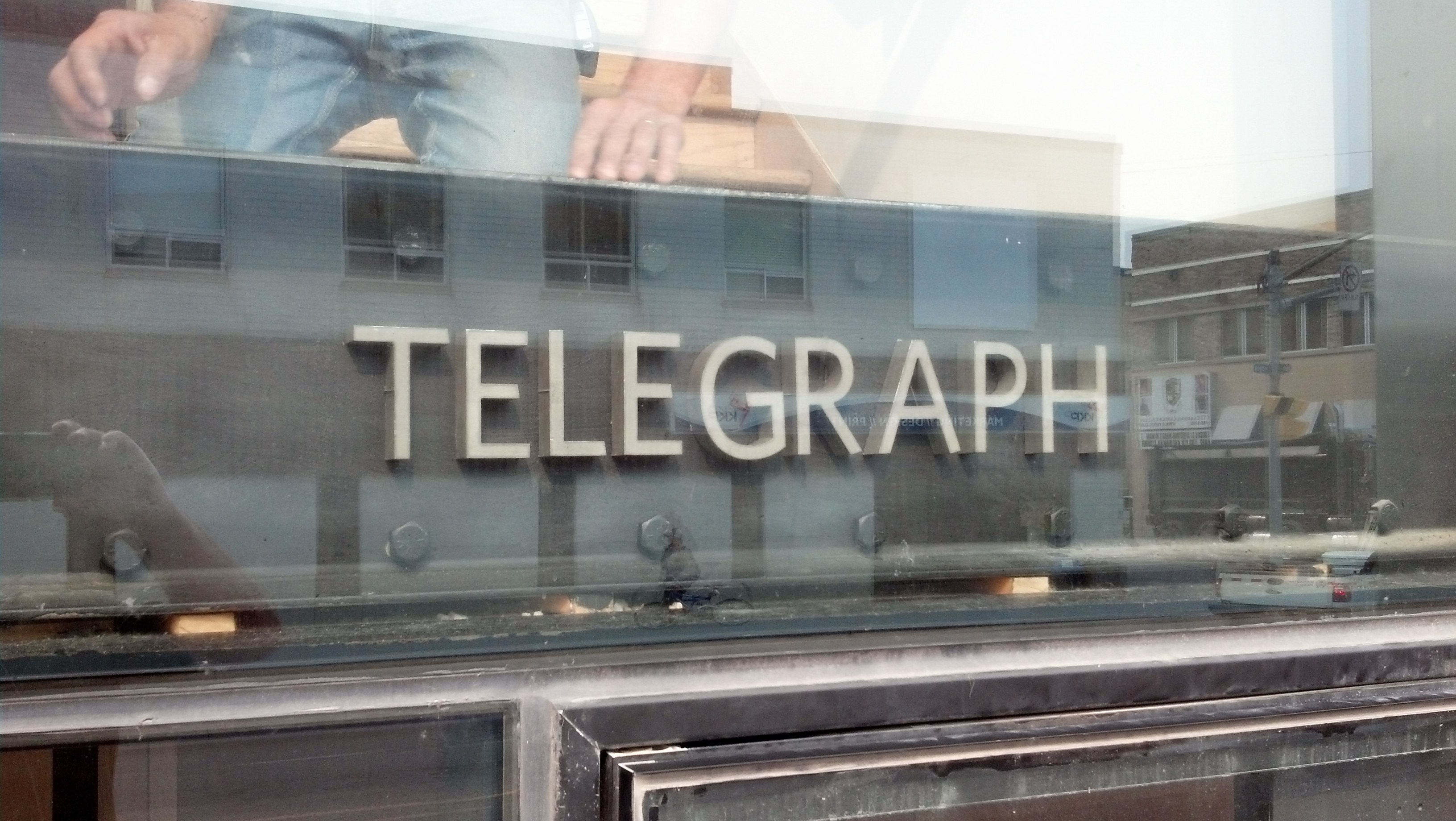

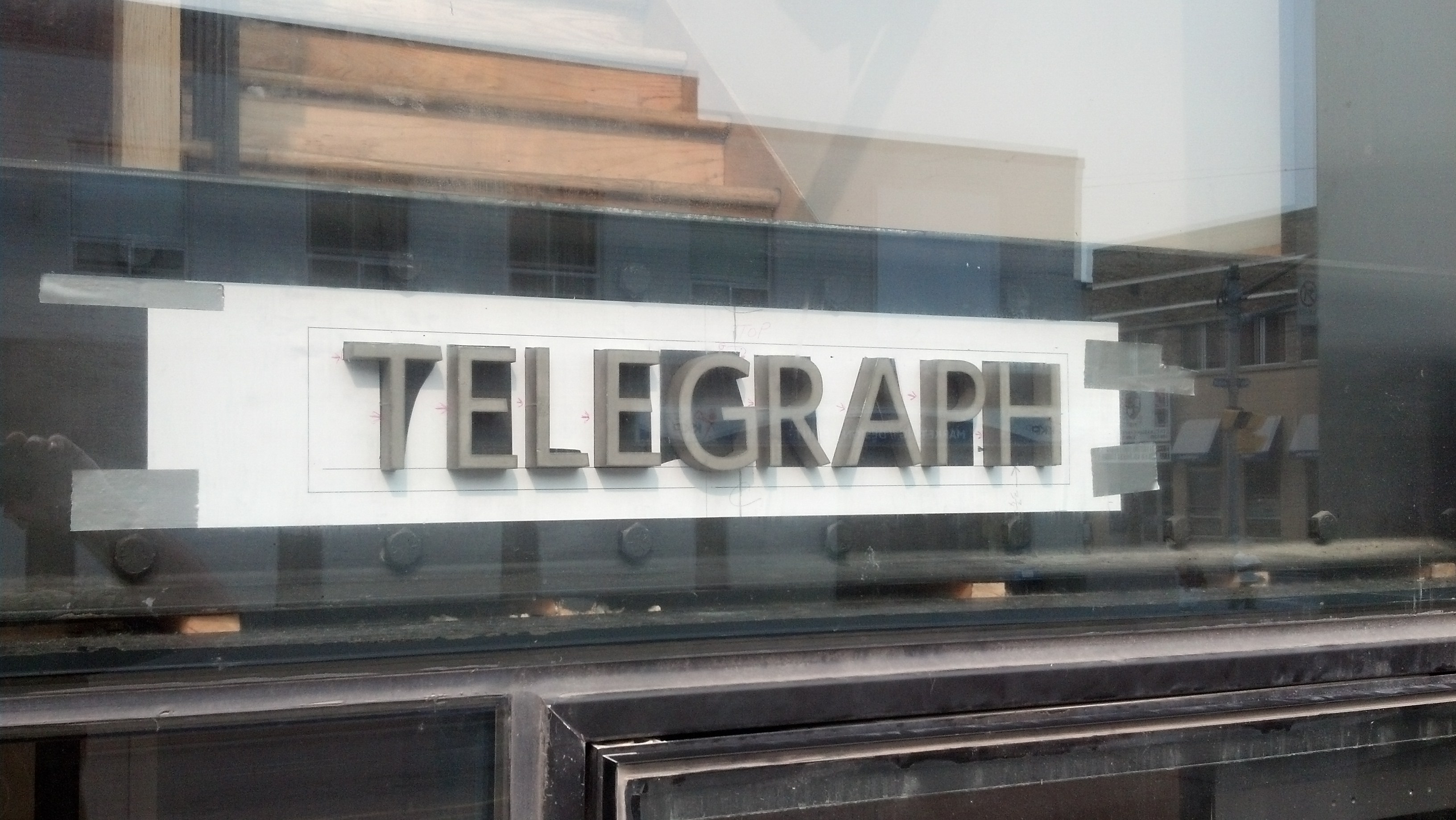

we installed 1" thick X 6" high STainless steel letters with 3M VHB tape7 years ago and they are still there looking good!
