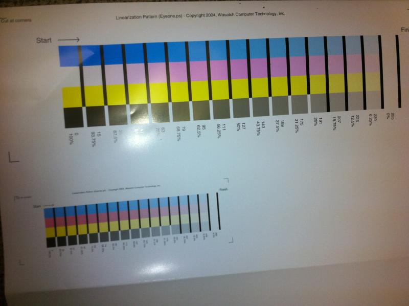

I have printed out some test sheets and from what I can tell it seems that Wasatch isn't dealing with the Magenta ink properly. It fades from white into a light magenta and then back into white. I'm not sure, but maybe this is where it makes the transition from M to Lm. I've attached a photo of the test print. The top print is from Wasatch and the bottom just using the Windows driver.
