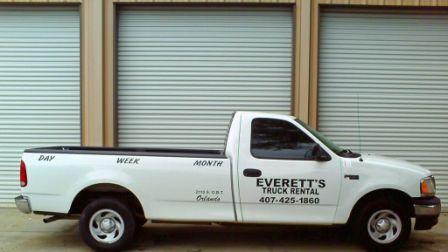

THEY STILL MAKE 8 foot bed pickups............and when the tail gate is down its now 10 FOOT...........

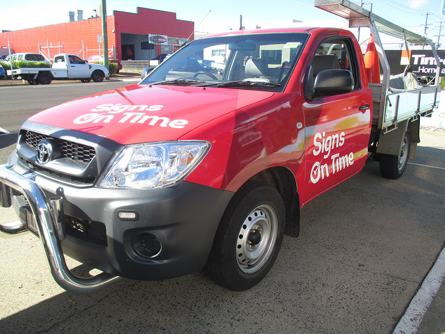

2550x1750mm aluminium tray with ladder racks & removable rack off front nudge bar :)
Lol thank you! I will keep this in mind as the year finishes out in case I need a huge write off!
i appreciate all the info and opinions so far everyone!

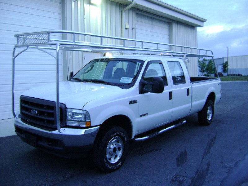

Put an 8' or 10' pallet in the bed with the tailgate up. I usually lay some cardboard down, put you sign on top of that and then a couple pieces of scrap coro where I'll strap it all in. Works good but then you have no place really to put any ladders. Have also used 2 ladders as the pallet with a piece of plywood laid on top of the ladders.
we use this method a lot, instead of plywood, we usually use a sheet of cor-plast since it is lighter and smoother surface
for the future we are looking to get a full length rack that will take a 60" x 120" sheet of material
