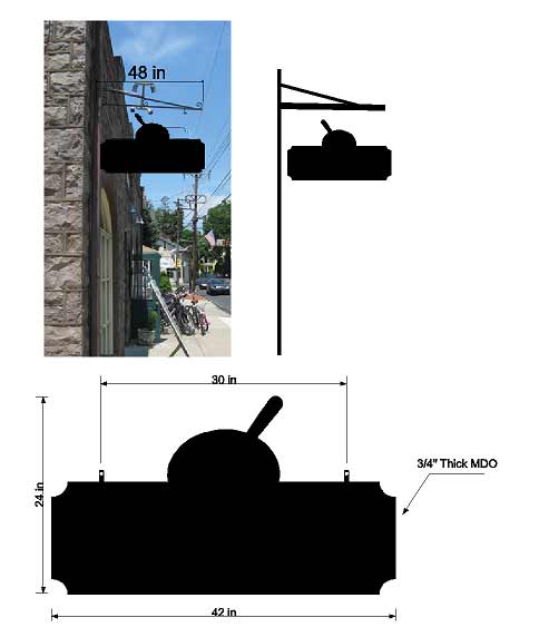

Hey all,
I'm hoping someone here could lend me some advice on this one.
I have to hang a sign - see attached pic.
The sign is 42" Wide x 24" Tall Custom Cut 3/4" MDO
The Bracket is about 24" Wide - off the wall.
The sign is going to have to hang kind of low due to it's shape.
I went to hang it and realized it was only 3-3.5" off the wall. (Customer supplied size)
This is no good - one gust of wind and it could smash into the wall.
I thought of adding bracket to the bottom left side of the sign to stabilize it, but realized that one gust of wind could twist the sign causing that corner (where the bracket is) to break.
What do you think is the best way to install this other than getting a new sign bracket? I'm not against getting a new bracket, but I'd like to explore a few other options first.
Any help would be greatly appreciated.
Thanks you.

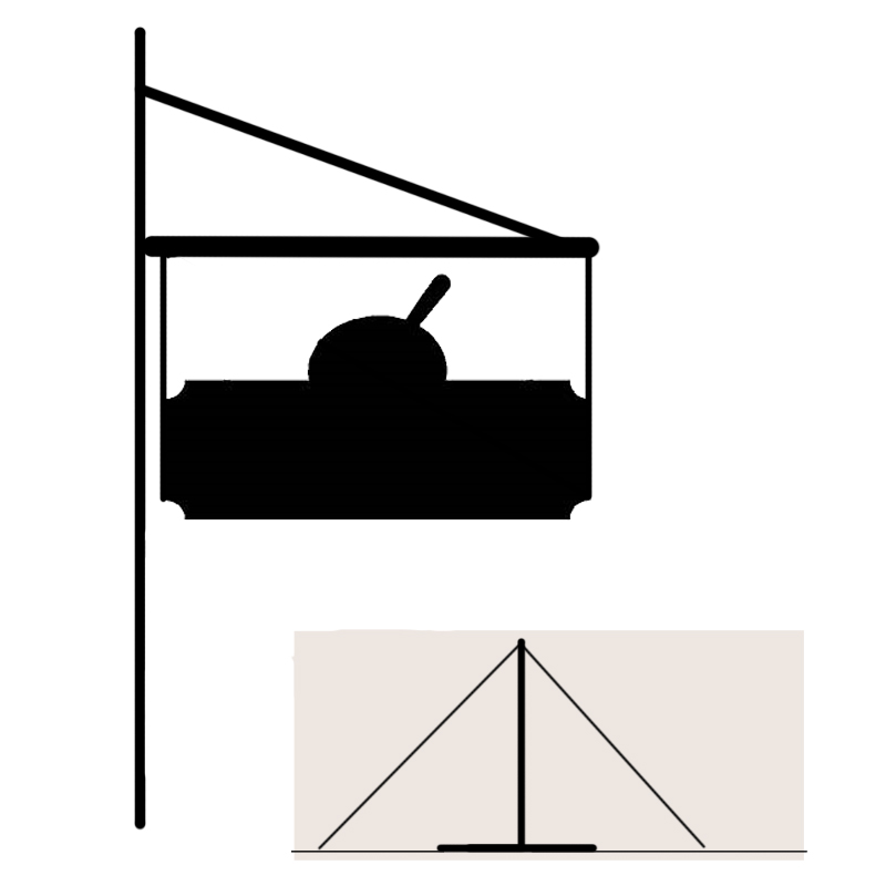

I used this installation some years ago on a hanging sandblasted sign, and its never moved. Use square stock metal tubing, with a flat mounting plate as a second bracket on the bottom. Fix it where it will be almost tight between the two brackets. I did this and it worked great.:signs101:
Thanks John,
That's a good idea as well!!
This is probably the most stable option. Might look nice as well!

I'm thinking more along these lines, although Deaton's idea works well, too.

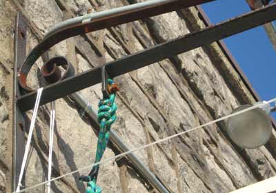

If I read this correctly the bracket is already there, so the issue is how to make it work with that bracket.
Sign_Boy
The Scroll Bracket is existing, customer wanted to keep it.
Could use a major sanding and some new paint.
The rope is not my work - had to throw that out there.
See new Pic.
As for the building's facade, it's stone.
