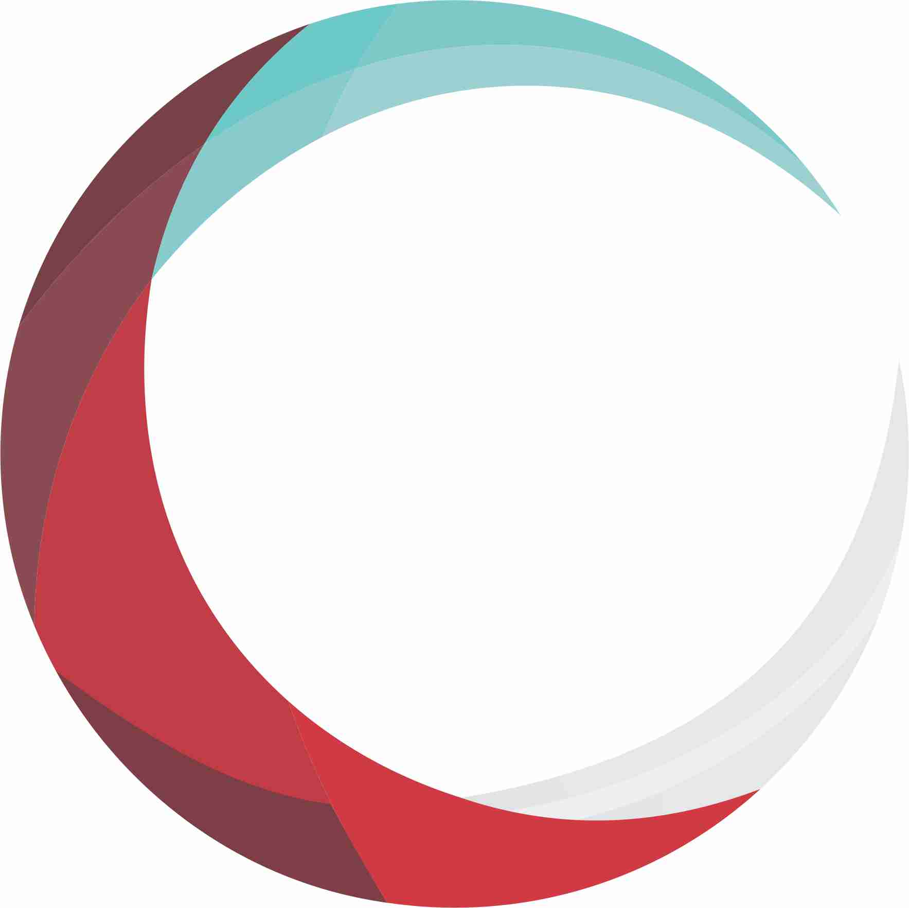

See this logo (I didn't create this design)? I basically need it cut out as the C shape. I don't know how I would put a bleed on it. 5" or so inches tall.
For this I would tell them to do a small negative offset path, which means instead of cutting right on the path, it cuts slightly inside the path. Doing this results in your actual path becoming the bleed.
