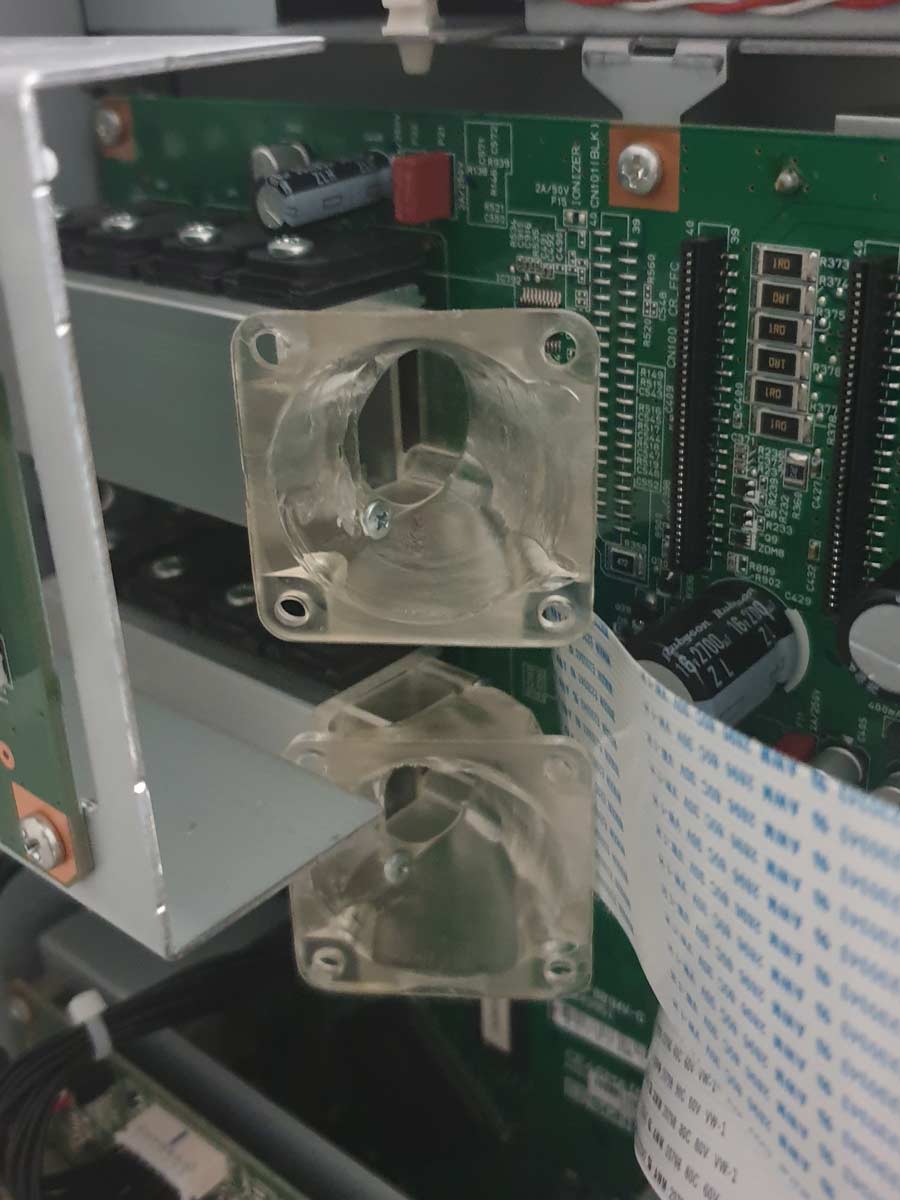

It's normal... they drove me absolutely mental, so I converted mine to silent Noctua branded 40mm fans by 3D printing some new shrouds which stepped down to the 25mm size. The printer is now absolutely silent when idle.

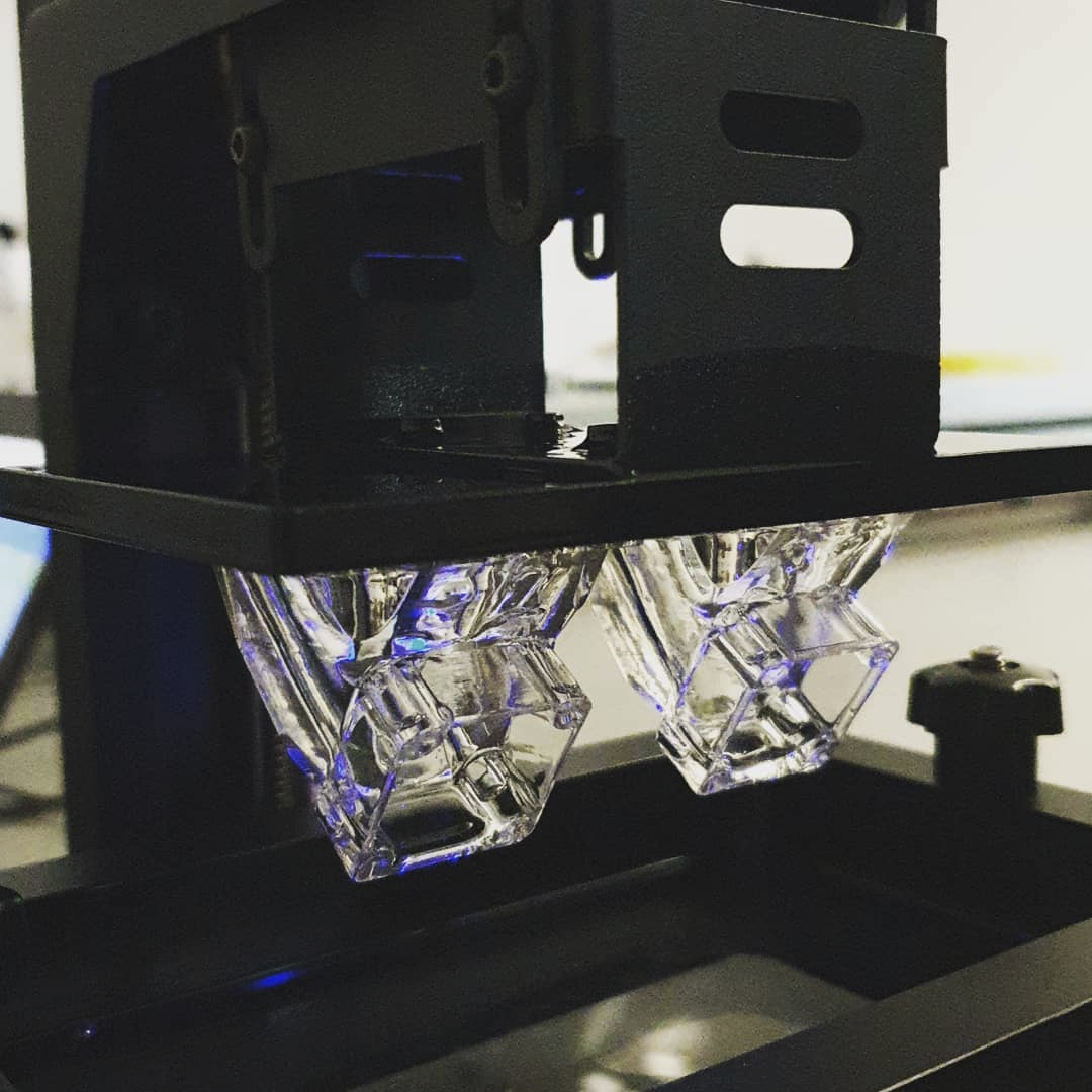

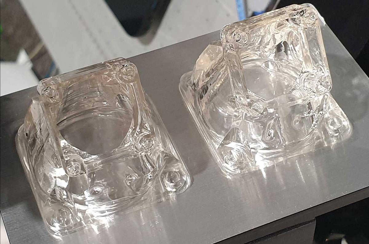

CanuckSigns, that's the 3D printed fan adapters (the clear things) still attached to the 3D printer after rising out of the resin, if I'm not mistaken. Very cool.

Saturn is spot on... these are the fan shroud adapters coming out of the resin 3D printer. The bottom "square" replicates the small factory fan skeleton. These attach using the factory holes and screws.
At the other end of the shroud is where the new silent 40mm fans are attached.

Fan shrouds out of the 3D printer:
Shrouds installed in place of factory 25mm fans:
Noctua 40mm fans installed. Had to use zip/cable ties as I couldn't be bothered 3D modelling screw threads:
