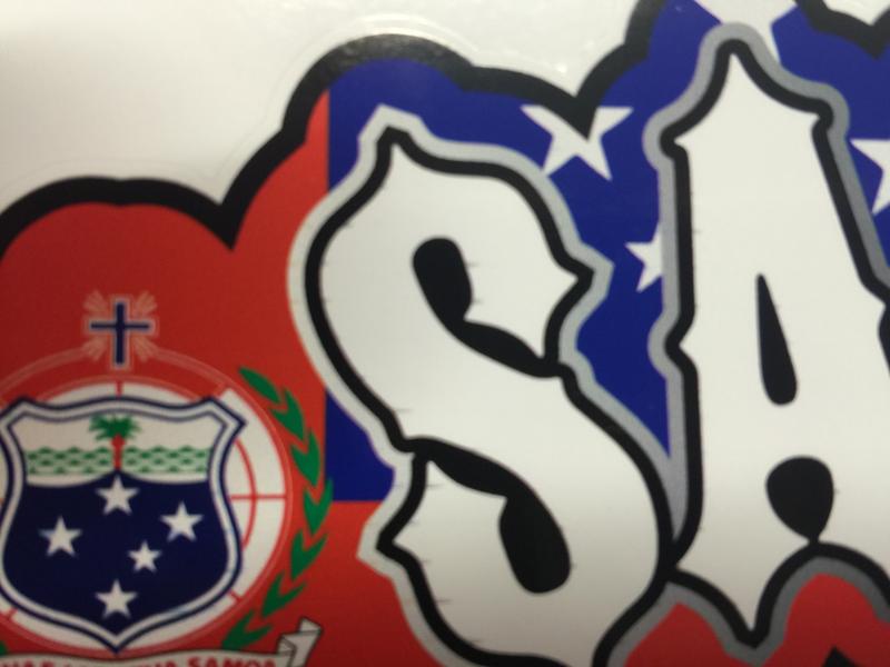

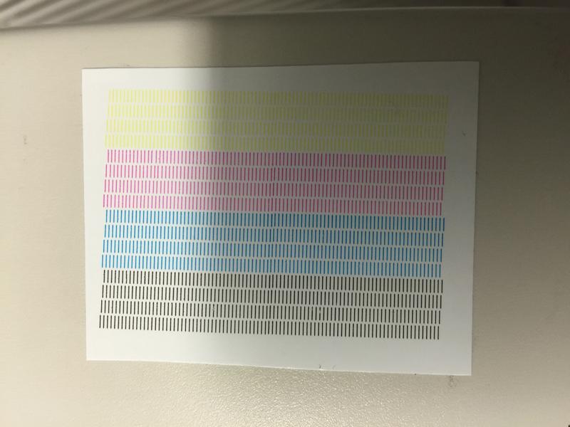

Hi guys , had this problem a little while , just did major service and head replacement and it got a little better but is still there
the head needed replacing anyways , it was shot lol
any ideas ?

Almost looks like you might have something dragging as it only seems to be going in one direction. get a good look at the bottom of the carriage. Clean spit sponge

hadnt thought about that, obviously clean around heads regularly, it I'll wipe down whole carriage and report back , thanks for the reply

thanks sooooo much , spent time cleaning the hell out of the carriage , but still same problem,
it was a small piece of vinyl on the tool carriage !!!
Lol
thanks for making me think it was a cleaning issue not a mechanical one
