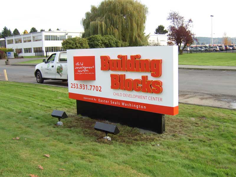

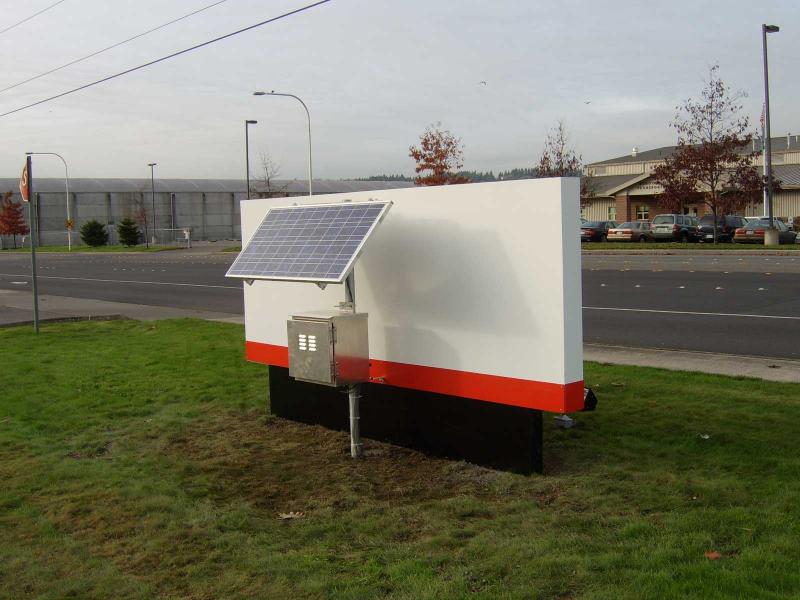

You can do it but its not cheap - you need to go with a commercial solar system. We did this job several years ago where it would have been really expensive to bring power in. This is in Washington where solar is not a good idea but with the right battery it works.
Wish I had the info from where I got it but I sold that business so dont have the files any more - search for solar sign lighting and you should get some good options, just remember you get what you pay for with solar.
