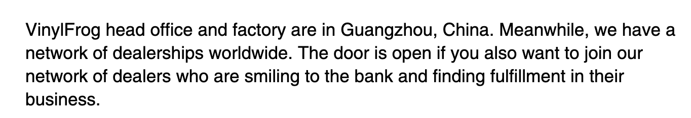

Doing a quick look at Vinyl Frog's website, there are too many things missing. Like life expectancy, whether it's cast, polymeric, calendared, mil thickness, stretch percentages, warranty... These are red flags for me. These are Chinese imported vinyls, which is why all this information is missing. You never know what you're getting as far as quality, some isn't much better than craft vinyl. If it fails or fades in a month, you know the customer will blame you because you installed it, or didn't warn them that it may not hold up. This is why I stick with reputable brands, my reputation is on the line too.
This is right off their site:
