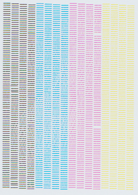

Things I would check:
Show us a nozzle check. You say there are some problems. They need to be seen.
Head alignment tests. Do them.
What is the humidity in the room? Static can be an issue from low humidity. It should be between 45-55.
Is the red off to one side? Could be the head is not level. Any head strikes or head smears?
An empty cartridge might cause it.
Have you changed a damper? The dampers can get partially clogged and this will affect the quality.
You are using Roland inks? 3rd party inks can be an issue.
How old/how much use has the head seen? It may be just worn out.

thank for the reply and sorry for the late answer...,
here is the print test print out...,
attachment.php
The head number one is under a billion shots count,
the head number two )magenta - yellow has just under 3 billion shots count...,
Dampers are new, encoder strip is new, the cap tops are new, data cables are new, existing heads...
no head strikes no smears...., I noticed that when I print a solid black square or rectangle I can see a bit of magenta on the edge of black left side bottom only...
The printed is positioned over a carpeted floor , could be static ??
Regarding inks , those are not original roland inks :(..., third party inks however they print great, I use the same inks on Mimaki JV3 for the past 4 years with no problems,
I have been having the problem since I bought this printer used, the original inks were roland eco sol inks and the problem I am describing had been also
happening with Roland inks...
any other ideas ?

Not sure... Are the dampers and caps Roland OEM?
yes they are, I just purchased the new roland caps from roland certified dealer....
What about the 3 Billion magenta shot count ? , should that head be changed ?
I noticed there is a lot of magenta spray around the entire capping station...
any other ideas ?
Solventinkjet
DIY Printer Fixing Guide
Is the magenta around the black fuzzy or sharp? If it is fuzzy, you most likely have an electrical issue in the head. If it is sharp, it's an alignment issue for sure. 3 billion fires is about half the life of the head but all kinds of factors can make a head go bad early.

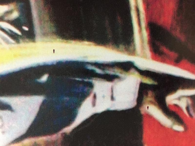

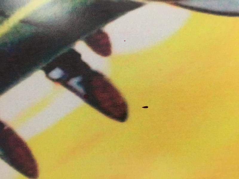

I find my XJ-640 dropping randomly throughout prints. This instance it was black ink, others its Magenta. It was recently serviced by a Roland certified tech and fresh dampers installed as well. Not sure if this is a static issue or not. It's not our everyday printer so I'm not sure if that would contribute to this or not.

63Comet
My problem is different..., my inks are not dropping but magenta sprays halo around black on vinyl - looks like magenta mist, also when I move the head carriage to service position the capping station is all sprayed with magenta.... I have a spare new head , wondering if I should replace that head, but apparently it's only half way it's life so it should not be that bad....
any other ideas
Ohhhhh, geez. Have you looked in the top side of the carriage to see if any issues might have happened inside? From your photo I thought it was just a bad jpeg.. didnt realize that was ink.
