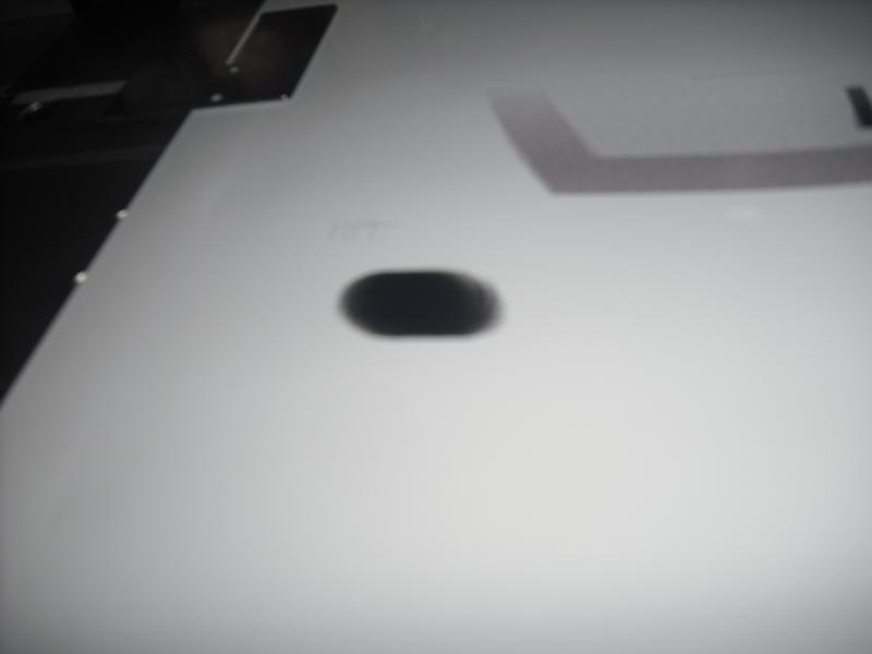

I've got a new problem, and this one is preventing me from printing anything! The printed image looks VERY blurry and skews off to one side as the image prints... it looks horrible.
It was suggested for my last problem that I clean my encoder strip, which I dusted off with a lint-free rag, didn't seem to help much, maybe I am doing it wrong? How exactly do you clean the encoder strip and could that also be related to this problem I am having??
The attached photo is what my crop marks are looking like, really blurry and misshapen... (it's not just the photo)

I just cleaned the encoder strip again, a bit more thoroughly this time (I'm afraid I'm gonna break something in there) and it seems the problem is solved for now.... who would think that a little dust on that thing could cause all this trouble, wish I had a dust-free room for my printer, I work out of a shop that is older than my Grandpa and is crumbling around me.
