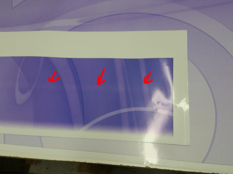

Here is the picture of the print. Tried print it in RGB & CMYK, tried all possible settings, different media... same results.
Changed dampers, changed cap tops, cleaned encoder strip, calibrated feed, calibrated bi-dr. Test print is perfect, all nozzles are firing. Checked for air leaks - no leaks, ink goes thru lines without any problems. Printing room temps about 22 Celcius.
I am desperate already.... having jobs waiting to print... fighting for 3rd day with it.
Any suggestions, what else might be wrong?

splizaat
Have you tried a different roll of vinyl with same results? If you get past that first stripe, and let it continue printing, does it happen again?
Did you pause the print?
reQ
Yup, same result on all kinds of media. And it does it again and again if i will let it keep printing. Some lines are bigger then others. I am using roland inks only. Tech guy will be in tomorrow morning and hopefully will get it fixed. Cuz i just give up, plus have more and more jobs waiting to get printed. He will try changing encoder strip\feeding motor, or trying anti static kit. Fingers crossed!
