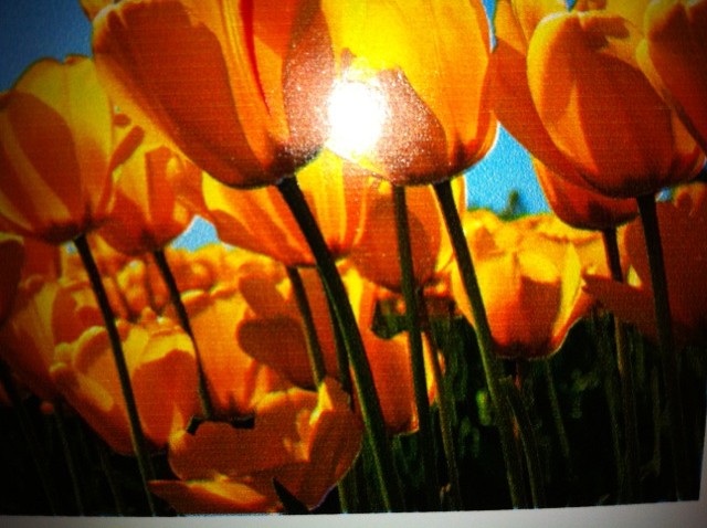

I have a SP-540V and print using VersaWorks.

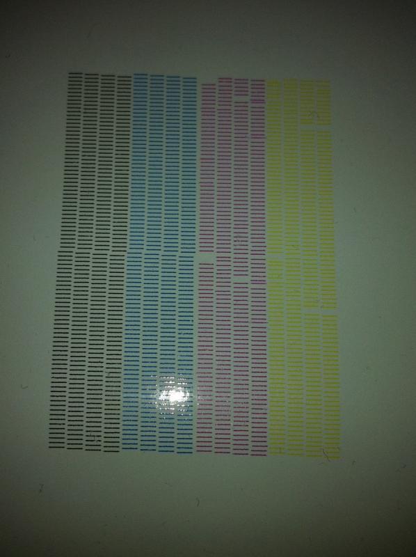

Every time I print I always seem to have banding lines thoughout the print, even after I have checked the calibration, making sure the two boxes meet without a gap or overlap. I have also changed from Bi-Direction to Uni-Direction, and the banding is still the same.
I have attached a picture of the banding problem, and a Test Print.
I emailed Roland Tech Support, and they said the following:
It looks like you have had a head strike. The Black/Cyan head is twisted which will cause slight print problems. You also have several missing nozzles on your test print which means you will get visible lines in the print (bands).
It is likely that if you cannot fix the missing nozzles by cleaning the heads then there may be scratches on the print head and these heads my need to be replaced.

I agree with the Roland tech, head number 1 (the K/C head) is definitely out of alignment. The good news is that you should not need a new head based on the nozzle test, but it should be physically aligned by someone who knows how to. If you bring in a technician, it should be a relatively inexpensive call as they should not need to replace the #1 head.

The banding at least in the image shown is almost only in the reddish part of the flowers, but not in the blue background, or blackish base. The magenta side of the head is missing a group of nozzles at the back of the head, so when the passes line up, there is a missing line. Aligning the other head won't correct that.

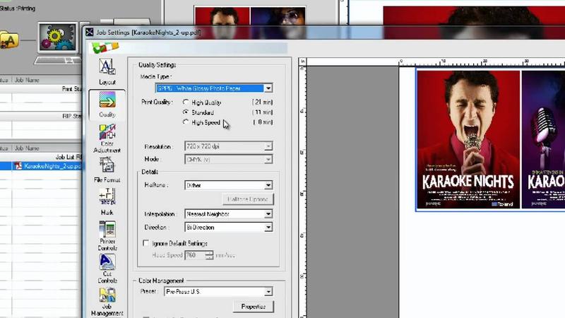

Where is this V to W pass setting located in Versaworks?
It'll depend on whether the profile has been set up to switch between V and W. I haven't had our Roland for about 4 years now, but this screen dump below looks about right, you'll see in the Quality tab there is a Mode option. On the screenshot it's greyed out, meaning it's only been set up for V ("CMYK (v)") but if it were set up for W that's where you'd select it.
attachment.php
You can also see above that wher it has Quality - that's where you'd select "High Quality" if you wanted to print with as many passes as possible.

WOW, that really worked great, I have been fighting some banding for a couple of weeks, soaked heads, cleanings, nothing worked.
I'm printing with a SP-540V on Orajet 3951 and used Generic vinyl III and selected high quality and W-PASS, and although the printer printed slower, there is NO banding at all, actually looks fantastic.
I never heard of or used W-PASS before.
