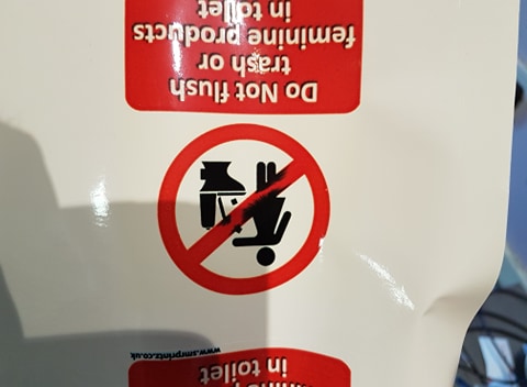

hi guys need some advise when printing stickers say for sample no smoking sign im getting a black bleedover onto the red from the black if that make sense i will add a picture to show what i mean

Did this just start happening out of the blue? It looks like it's laying down too much ink. Does the vinyl start to crack and raise up after sitting for a while? It's hard to say but it could be a bad/incompatible profile, bad material, bad ink batch and/or improper heat settings.
shaunie44
not sure mate not long got machine of a friend only noticed it on these sort of stickers but if i print with a black boards around sticker the boarder is spot on
