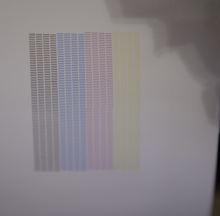

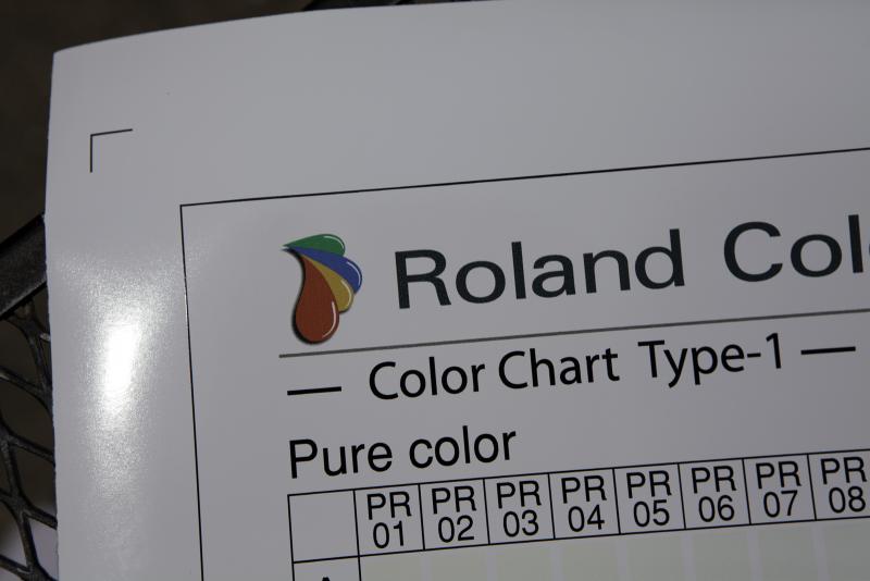

my colors are printing with white spots not solid colors not even the blacks sometimes. you can even see some banding in the red which bands on all colors. even my blacks are spotty and bandish.
but if you look at the text that says color chart type 1 and below it is all perfectly color black. no banding and no spots, same thing with the black line boarder and crop mark.
i am using versaworks
anyone have any ideas on what to do thanks
apex
orcal and roland eco solvant max
the bottom of test print looks blurry but thats only because of the camera, the print looks perfect to me in person
CS-SignSupply
Ok. Looks perfect. Next...
