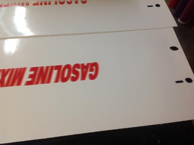

I have an SP540v. I was trying to do a print, laminate, cut..and it keeps doing this.
I am not sure what's going on. Any suggestions?
petepaz
Yes try cleaning the encoder strip first but don't use any thing other than ordinary rubbing alcohol.
