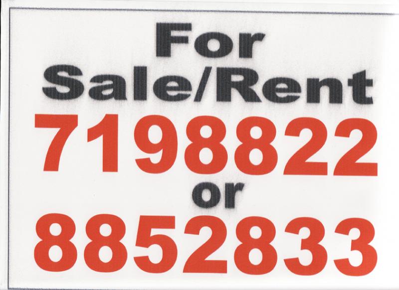

    Hi I have the same problem I tried to use syringe already but still when I print the black is still mess up
    here is the sample of my print out, please help me Ive been trying to fix this problem for a month now, thanks...

    my printer was doing exactly the same, I was going crazy about it and I almost buy a new print head, (with labor about $1,300.00), I start using Jetbest ink and oracal profile 3561 and............. magic.......... the print heads after 1 or 2 days of normal printing (2.5 hours a day for me) cleaned itself, now when I do a test print it looks pretty and the black is black, not stripped like your sample.
    try to flush the head with solvent cleaning fluid from the dampers: remove the ink line going to the damper, place a hose on the damper and at the other end a syringe with cleaning fluid and push it through, (I did and remove a hose from the pump and placed to the damper) just make sure the cleaning fluid falls in a container.
    good luck

    Mine wasn't printing the fuzzy outline you are getting....you might need a printhead? Not positive on that though. Mine was just air in the line and I used a syringe with the capping station against the printhead and it pulled the ink right through and got rid of the air in the line.

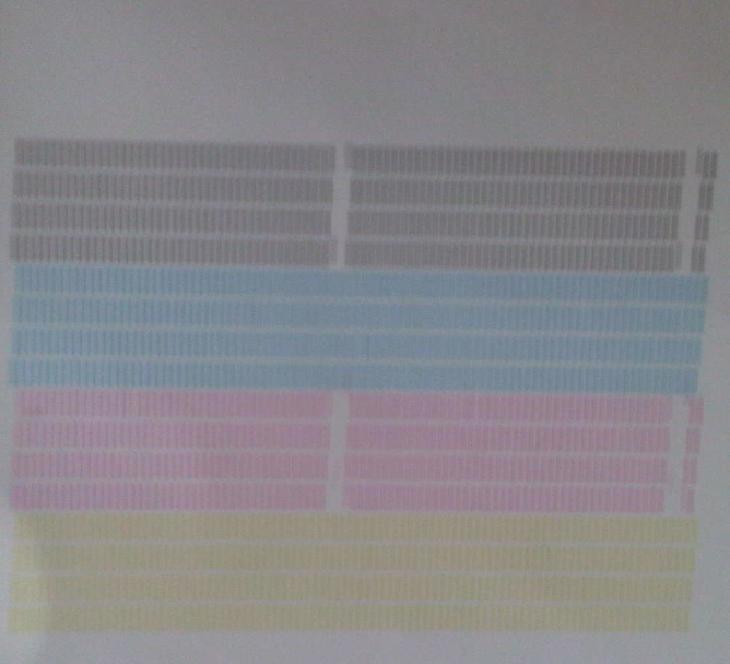

    Hi I just started to have some banding on my sp 300i, it worked fine for 1 year and now this banding appears especially on black but really on all colors. Did my print test and both black and magenta have 2 lines missing each.
    Roland technician said I did not do enough power cleaning throughout the year, but I did do the normal ones. I am not sure what to do, I read that it could be air and to remove it with a syringe but I am not sure how to do this. Please help! thanks

    Post a pic of the test print please
  11. esoesmio
    esoesmio New Member
    6
    Jan 10, 2012
    I am not sure how to post the picture but I uploaded it in photo gallery sp 300i guayas
  12. Inspect the face of the Black and magneta head, willing to bet you have either a scratch or a dimple in the printheads (happened with a head strike). If so, time to replace the heads, no cleaning will ever get ink flowing to a damaged head.

    Roland guy came over today and did a major cleaning took everything out and all is the same.
