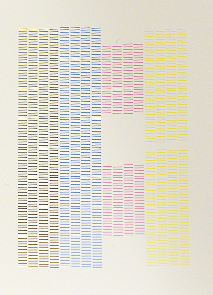

Yes, NO no magenta or yellow on test print (after sitting unused last week).

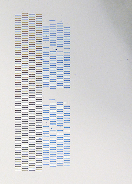

I cleaned the wippers, doing some MED head cleanings now, 50% of the magenta is back and most of the yellow is back. I'll keep cleaning and send a test file with just yellow and magenta t see if that will help.
  • Second test after cleanings and adding cleaning solution to cap station.jpg

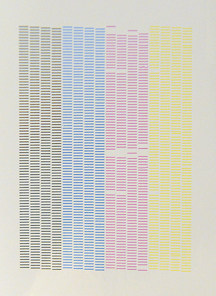

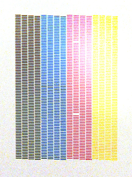

Well after soaking the heads for 11 hours, doing one regular cleaning, and three medium cleanings between printing test prints, almost all nozzles are back.
However (see attached test print), what should I do next to get 100%?
When the test print is printed, printer prints one block of the four colors with one nozzle blocked, them prints the second block of four colors and it also has one blocked nozzle, question is this considered one or two blocked nozzles?
BTW: The printed nozzle check lines are not fuzzy, that's just the poor quality digital image, the printed lines are very crisp

There is only one nozzle still with problems, this should not have an effect to the print quality. It could be that the nozzle will start working again during printing.
I check cap tops with a syringe connected to the tube of the cap top. Depending on how easy how much ink can be pulled with the syringe a problem can be detected,
