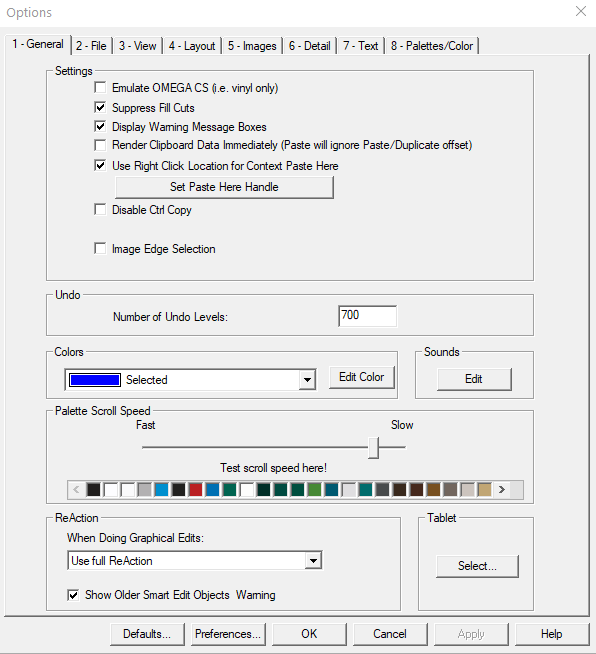

Do you have the up and down arrows at the top and bottom of the palette?
should look like this
if you don't try grabbing the horizontal bar at the top and drag the palette into the middle of the screen. You should then see the arrows and be able to scroll the colors. If the colors go by too fast and you only see the first group and last group go into TOOLS>OPTIONS and change the palette scroll speed. Most new computers will need the slider all the way to the right to see the colors scroll.

Hello Adam,
Thanks on this,
I have, had it vertically on the right of my screen, but only the one, Gerber Standard foil Palette..but still no where near the amount of colours I have on Omega 3.0??
I have it now , horizontally in the middle of the screen though, and can't get it back to the right hand side again....
Unless I turn off and re start..

Ah,
double clicked on that pallette in the middle of my screen, AND more spot colours have appeared??! But that is great news.
Thanks Adam for making me do this, much much better now when importing from Signlab, which I am so used to doing..
