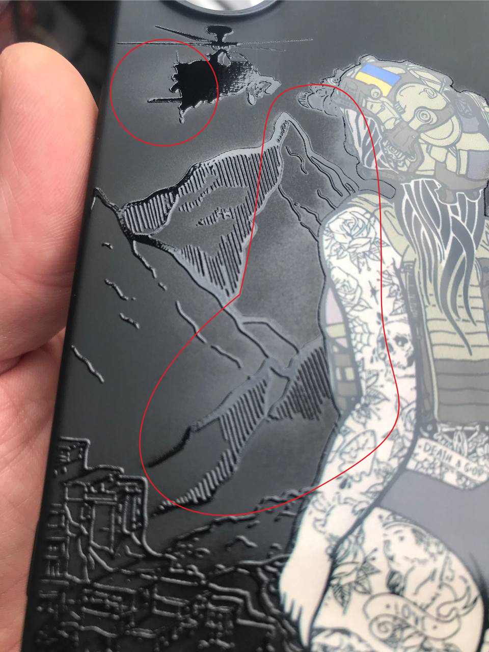

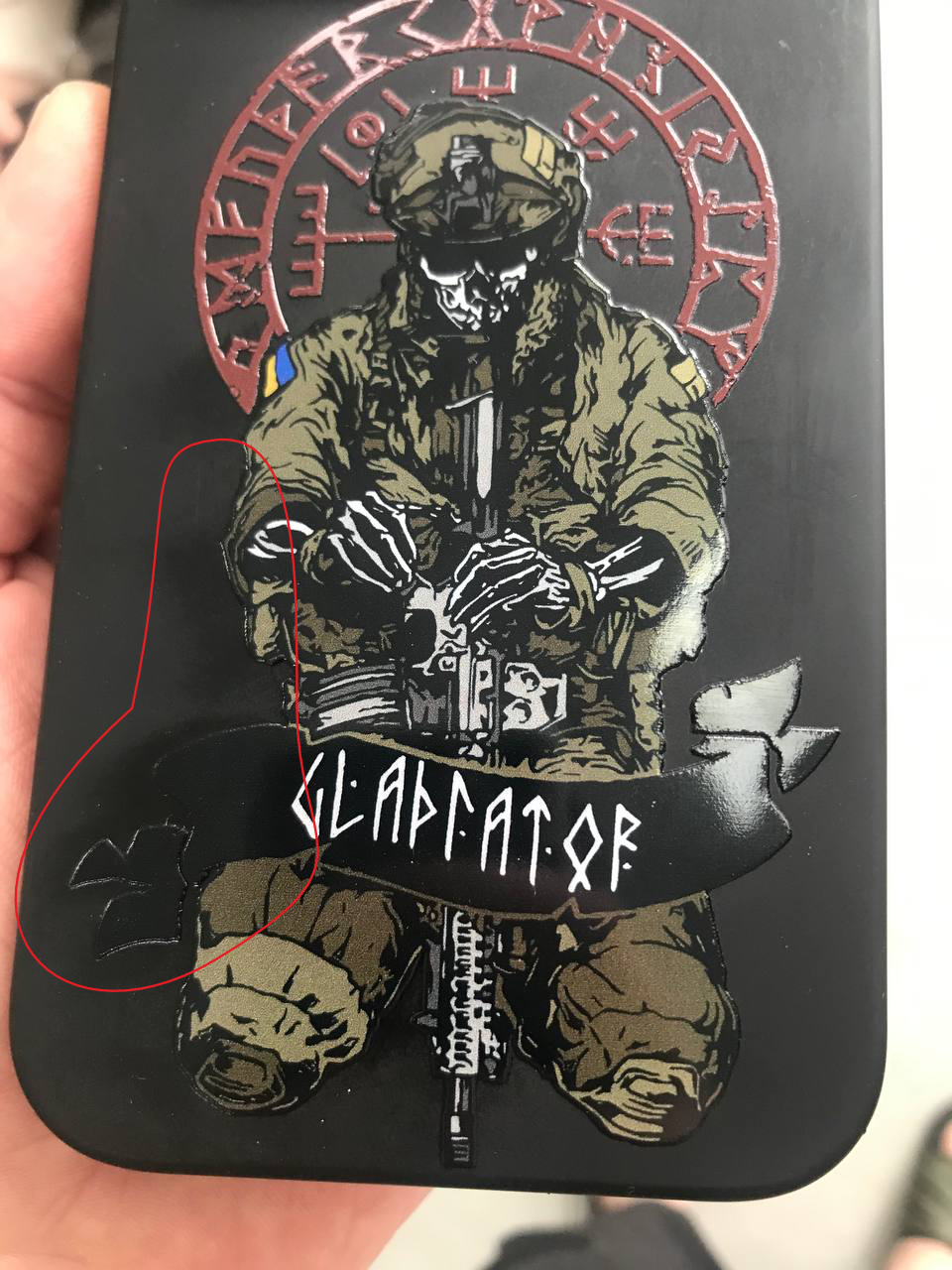

Help me figure it out. Ink is sprayed from the left side of the picture. Always from one side. Changed LD1, LD2 modes. Adjusted head gap. Temperature 23C, humidity 40-50%. If you try to wipe with a stain, a black and red mark remains on the fabric. That is, it is black and purple dust.We also installed an ionizer. No result. photo_2025-07-09_12-06-491.png photo_2025-07-09_12-06-49.png

Weird it’s always the left side. That definitely smells like a head height calibration issue or some kind of air draft.

The reason it is on the left side is because the printer only prints unidirectionally.
Check the underside of the ink carriage and make sure old ink hasn't built up around the heads.

I think lenard912 means there could be some air flow (fan or something) blowing air under the heads... If there are any broken ink droplets (imagine a single squirt of ink from nozzle breaking up mid-flight into a main drop with some "satellite" droplets, they could easily be blown off course and have an overspray effect like that.
Are you using genuine ink? If there's a discrepancy in the ink manufacture with viscosity or something like that it could possibly have a similar effect if satellite droplets are formed from the drop ligament as it is squirted.
Does a test/nozzle check print show any signs of overspray (probably need a microscope as will be less ink)? Is it just the black? Does the same print on another material have the same effect?

the test looks normal. we didn't look under the microscope.
the ink is original.
there is no wind. the air conditioner is far away and we print with the lid closed. so it definitely can't shrink.
this happens on different materials.
we print 6 cases. maybe without spray, maybe one, or maybe 2,3. regardless of the position on the table.
if you print on transparent acrylic, this spray looks transparent (just a murky trail). but if you rub it with alcohol on the fabric, a black and red mark remains.

Definitely check the height/gap between head and substrate as others have previously mentioned - as too great a gap means more distance for ink drops in-flight and more chance for something to affect it (including static). If there is a discrepancy on the table being level in relation to the heads it will likely need adjustment.
However, given you say it can happen to any case regardless of position, I wonder - do you wipe the cases with anything before printing, introducing an electrostatic field - is that a very consistent process? It'll be a case (no pun intended) of narrowing down the possibilities but I can't think of one that would randomly affect something across different areas of the bed outside of there being something different with the substrate itself.
Just another thought - not sure if it's relevant in your case, but the original Mimaki 3042 has a mist filter (and fan in the head transport) - if so, do you know if that's working?
