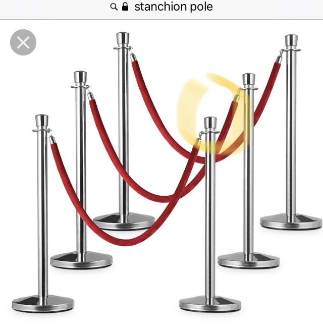

Hey guys is this cap removable? Tried pulling and turning and nothing happened. Long story short customer bought a few sign holders that go on top but wont go in with this cap on

If I remember right that ring the "rope" hangs from unscrews. There is a long bar with threaded top and bottom that the bas is attached by big nut and top srewed down to hold everything tight.
Channel locks should help loosen if they are to tight.

If it went on and it's not welded in place it'll come off. Fundamental principal of mechanics.
