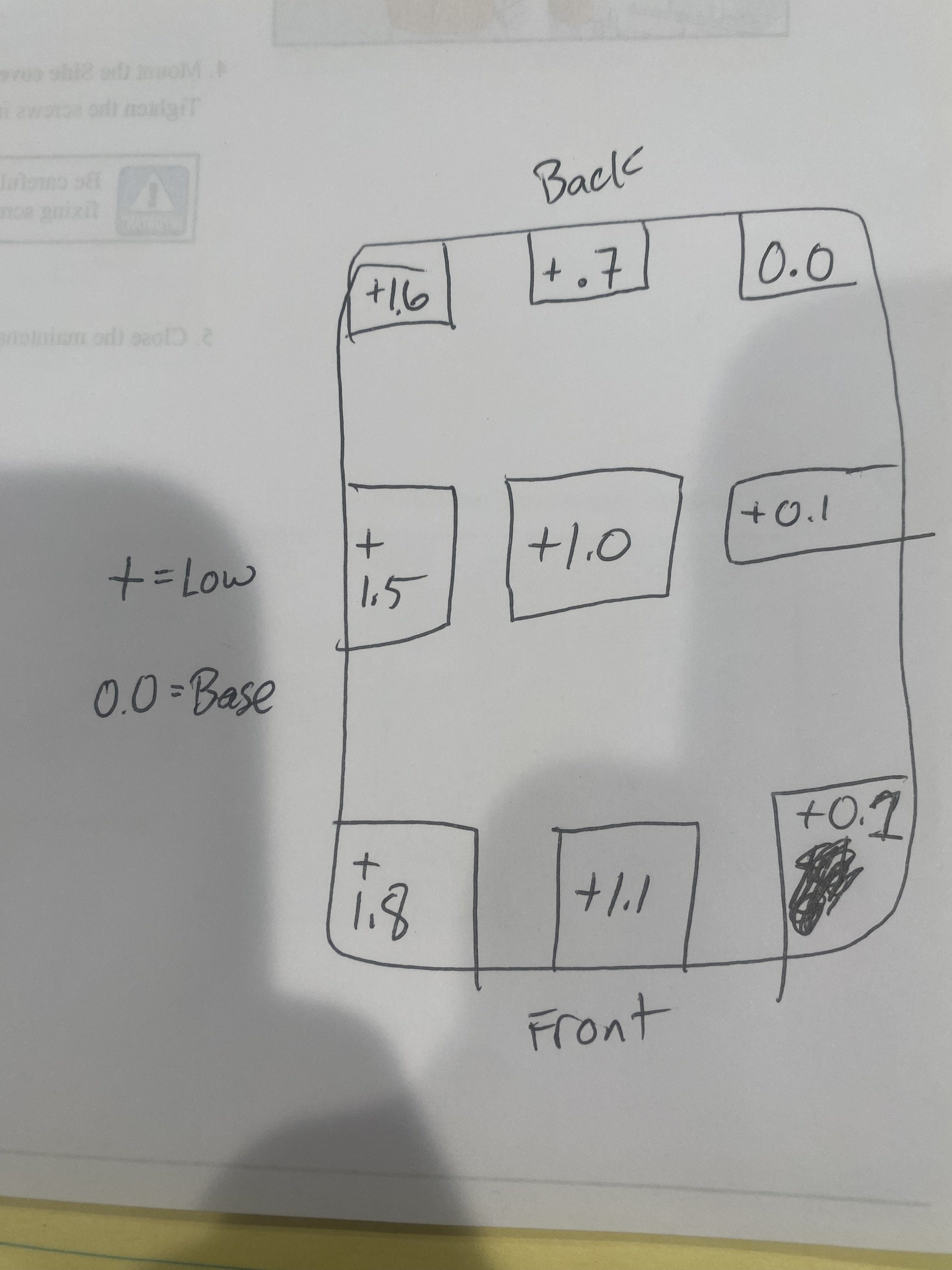

It doesn’t mess with the leveling/balance?
I have one of those heavy duty metal frame benches with a wood top from ULINE. My printer keeps going out of balance. Left side of table is lower than the right side.
Service tech via email said it was the level of the printer and not the laser, but I swear it’s the laser.
(Photo for reference) the higher the number the lower it’s sitting.

Direwolf135
Measurements are in millimeters.

Smoke_Jaguar
The factory stands use screw-down feet to lift it off the wheels, but the bed itself on the MKII's move so it's not a high accuracy thing. Don't have to be crazy level like you would with something like a JFX200.
Direwolf135
I’m using a jig and I’m only able to print on the right half due to ‘ERROR 505 work high!’
It’s a constant (3x in 1 year) issue.
