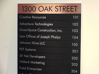

HulkSmash
You can get pretty creative with these, and keep them really simple at the same time.
Attached is -
Modular directory sign with copper aluminum header, black anodized aluminum namestrips, brushed aluminum trim and vinyl lettering.
