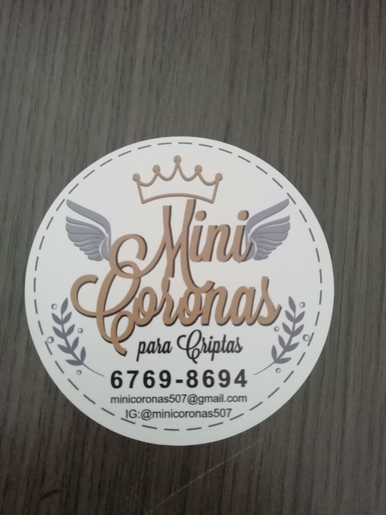

Yes ! OPOS calibration was made several times. From 5 times, it only pases 2 of them. I changed the 2 outer pinch rollers, the other 2 are in regular condition. I also changed the cutting strip. I know is an old model, but it's the one I have !! :p
RICHARD SIMMONS
It's not cutting in the center. Look the bottom and upper sides

If it's reading the OPOS marks then I'd venture a educated guess and say it's not your OPOS reader. Try a factory reset - I've done this before to resolve odd cutting behaviour. What printer are you working on BTW - a latex?
RICHARD SIMMONS
Hi Stephen ! Thanks ! I'll try to make a factory default and see the results. By the way I'm printing on a RE640 Roland ecosolvent printer

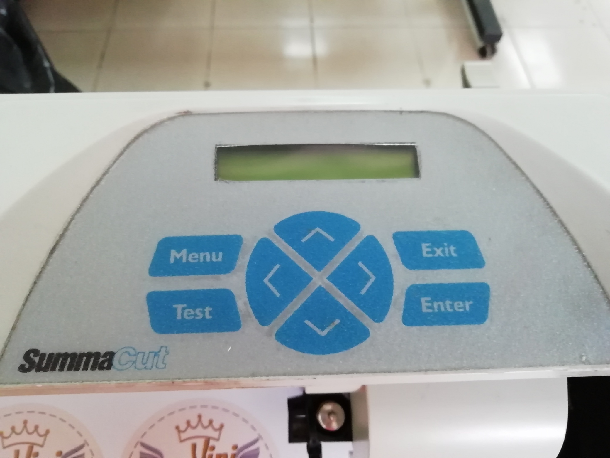

On older machines were OPOS was an option, it is possible to deactivate OPOS through the service mode of summa cutter control, and reactivate it later. Could help too, and will not reset the whole machine. Simply forgotten, its such a long time ago :) .
RICHARD SIMMONS
Service Mode Summa Cutter Control: press "Shift"-Key when booting.
Thanks Frank ! Excuse me if I don't understand too much about this, but see the attached photo. There is no "SHIFT" key. Do you mean from the Winplot program?

FrankW
Summa Cutter Control Software. Downloadable at the summa website. Do not change anything other in the menus except deactivation of the OPOS-Sensor. Should be in one of the main menus, not in the parameters list. If you do not find anything, switch machine type to a model without OPOS and back.
