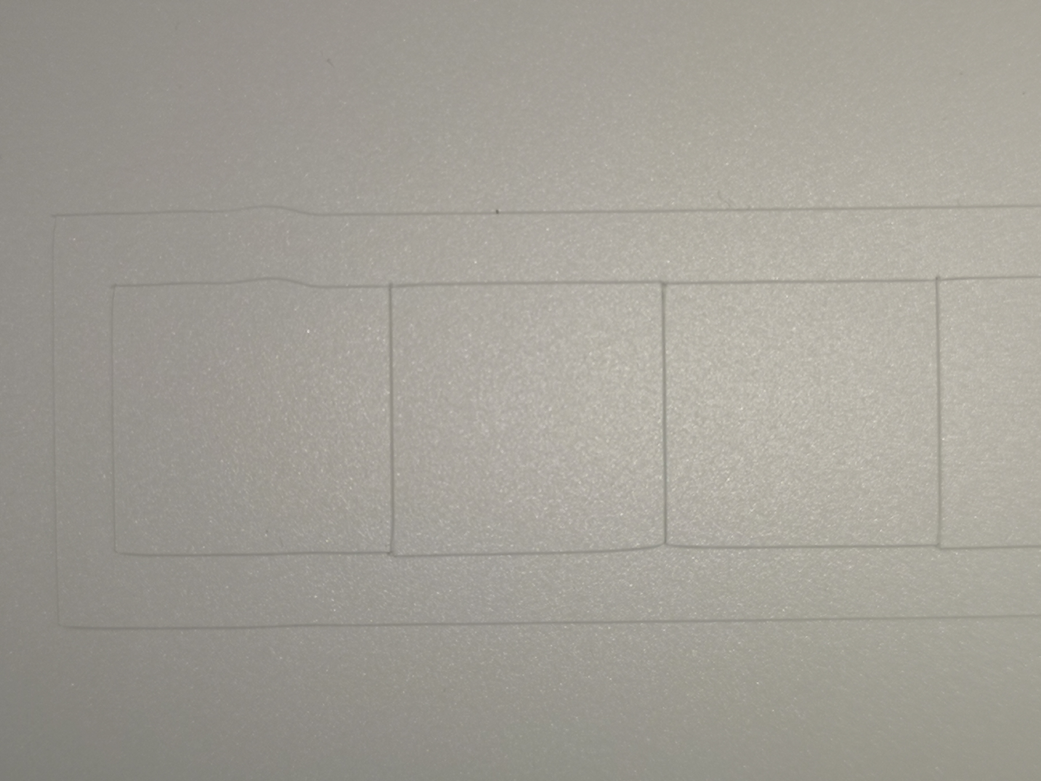

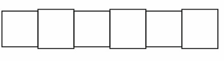

Hi, got a little problem with the Summa D60. When i cut a Offset-test on the D60, the output is like the attached image. Setting the offset lower or higer has no effect. What;s going on?
What is the part number of the blade you are using? What is the offset you have set right now?

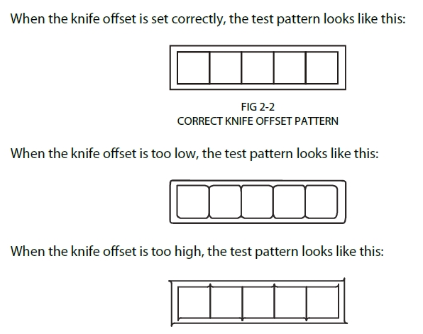

The image posted by vjslof does not appear to be due to an offset error.
The problems due to incorrect offset setting are shown in this image, as described in theSummaCut manual.
The problem shown by vjslof appears to be due to a knife or knife holder defect.

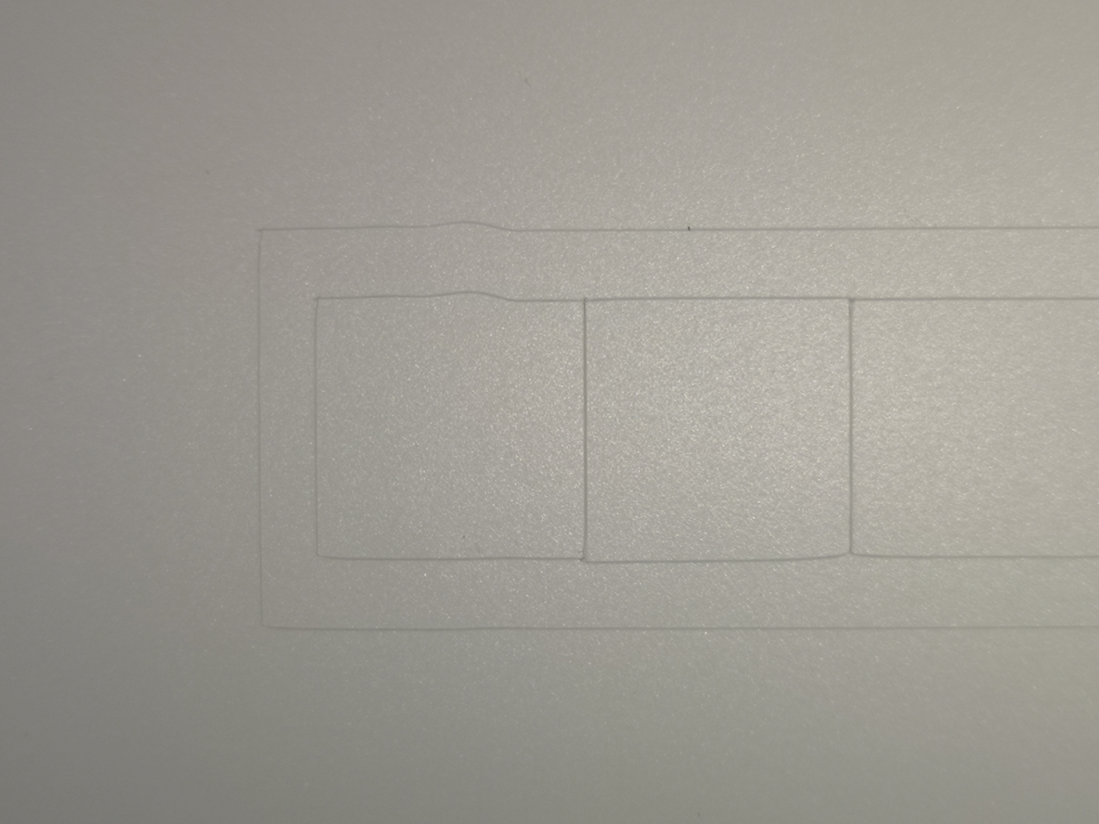

I have the same problem. The rectangular shape supposed to achieve is not consistent.
Have any idea about it?
Summa d120.
