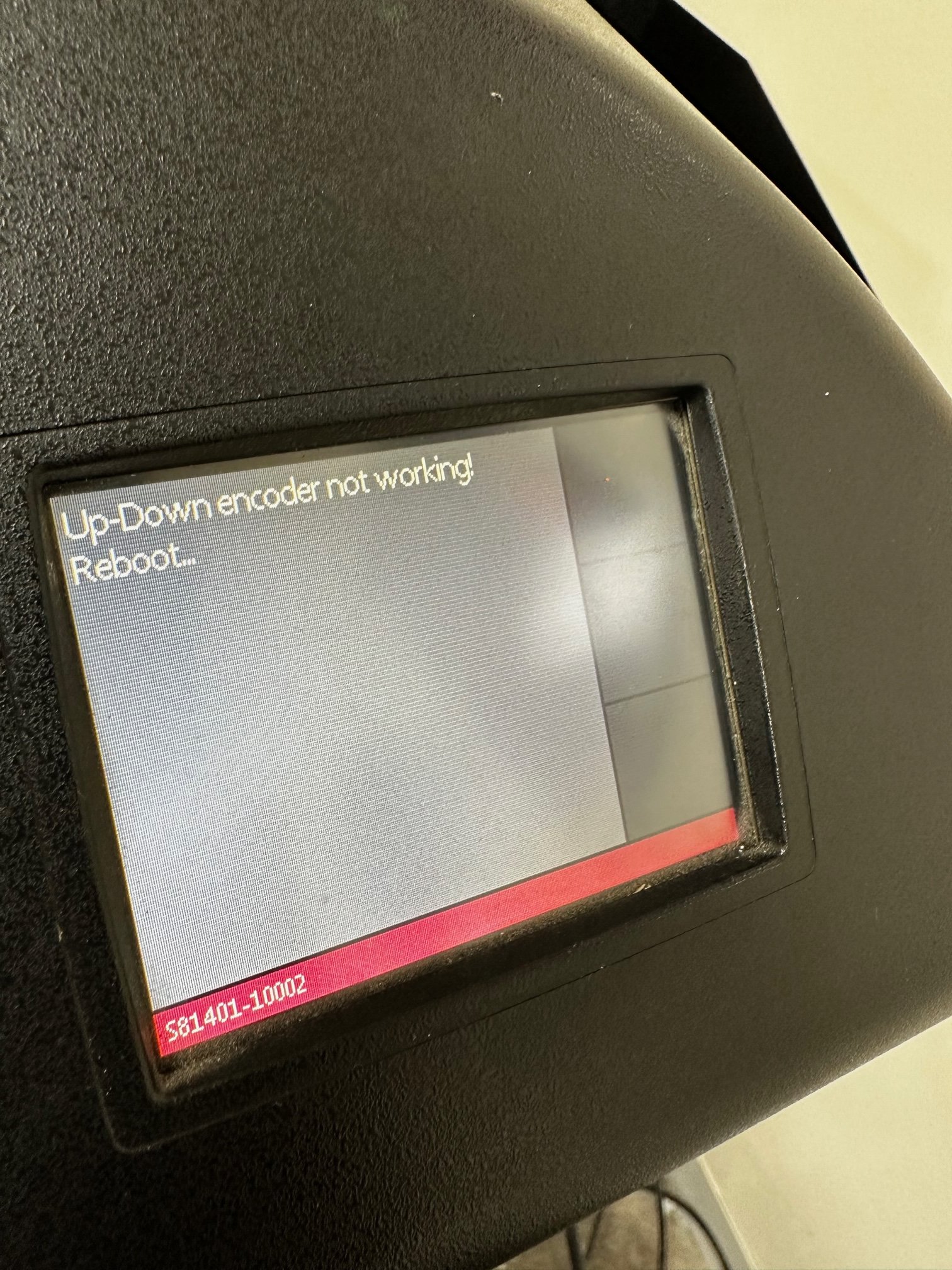

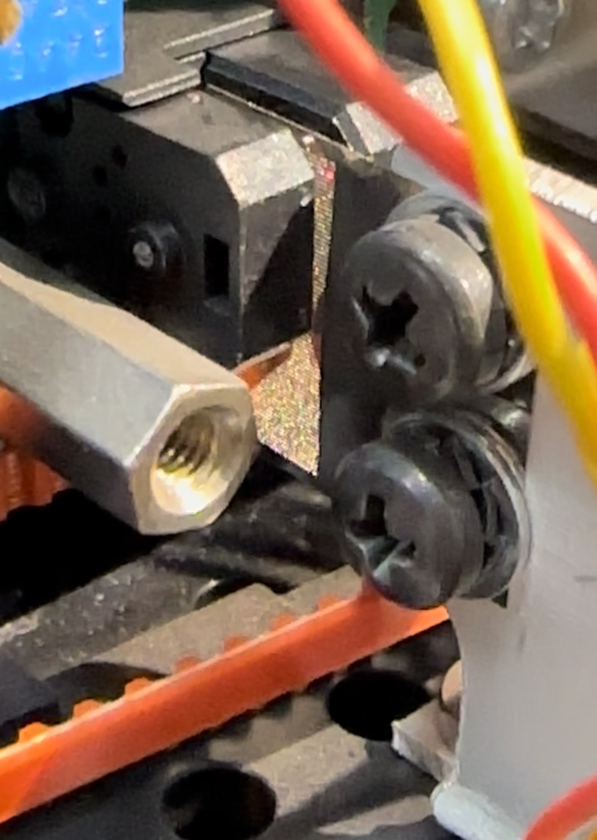

Lugsy63
When I load media into the summa I keep getting this error message 'Summa up-down encoder not working reboot'. Anyone have ant answers? S2 T160
Spoke to a tec and they've mentioned blowing compressed air onto the part attached. Hasn't done anything.
cornholio
Does the head move the blade down, at the end of the init. process with media inserted? If not, it's the solenoid, flat cable or the mainboard.
