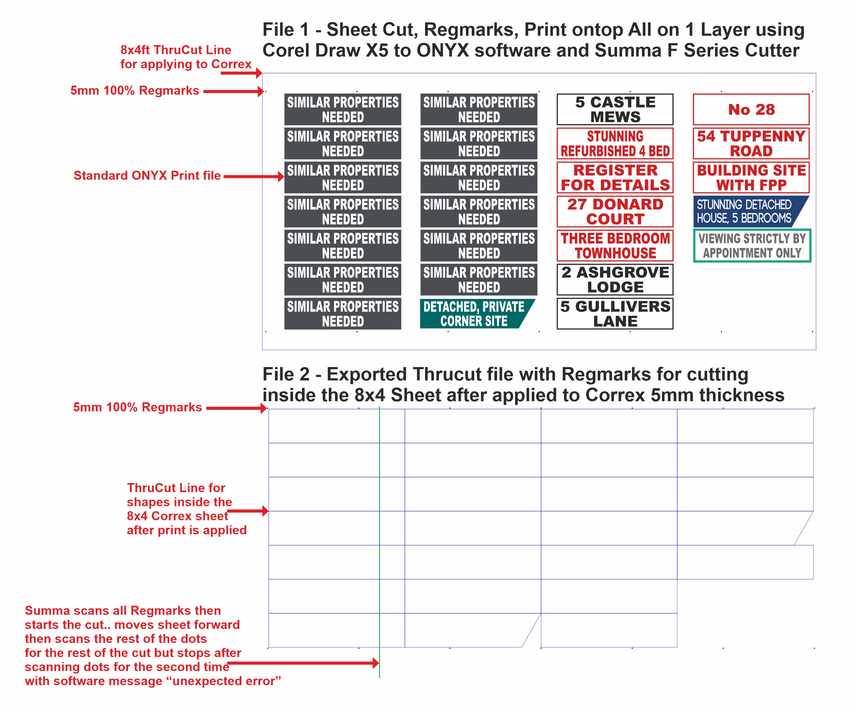

Hi all, new to this Summa stuff but this is a basic print & cut with usual marks and cut lies, nothing fancy. normal export from CorelDraw x5 to PDF for print with Thrucut for outter sheet size then apply to correx 5mm then back onto the summa for the shaped cuts but after scanning and cutting the first part it then scanns the dots again for the next part of the cut but sopt with unexpected error? See attached image which may help - Many Thanks

We had this error with out flatbed Summa. It turns out we had several double lines in our cut file. AKA two cut lines on top of each other. So it would crease the material, and then when it was time to cut it, it would just freeze and give us an "unexpected error has occurred."
Maybe double check to make sure you don't have any lines on top of each other in that second part?
