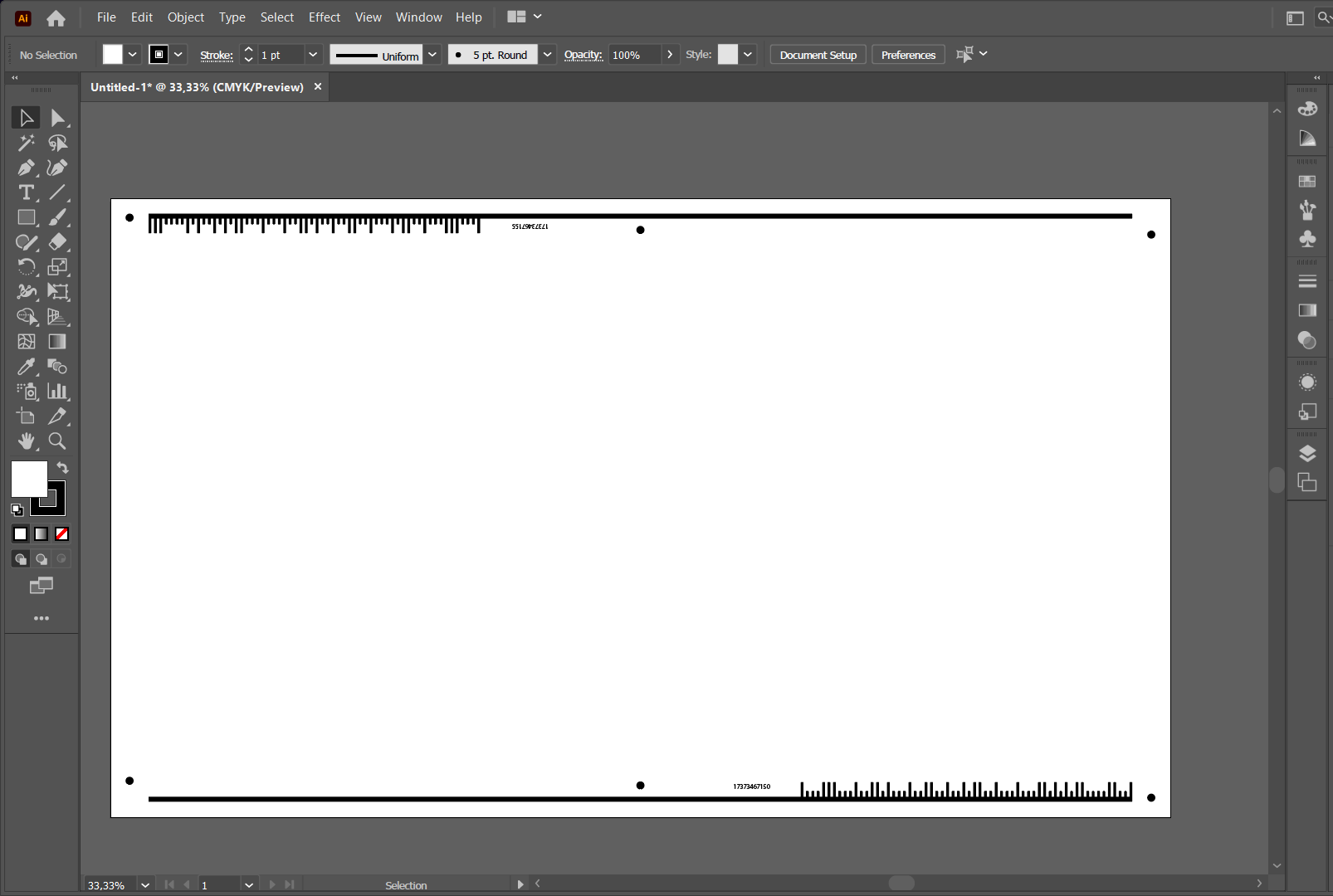

99% sure I'm done... knock on wood. Only thing I'm not sure about is if the barcode that ends in 0 or the 5 goes on the top of the artboard... or if it even matters. Got it generating the 11 digits, plus 12th BS checksum digit.
So it does a few things -
Step 1 - Generate the barcodes
Step 2 - Resize artboard by .6" on sides, and 1.25" on top / bottom, places the barcodes there
Step 3 - Generates circular fiducials every 12"... With the fiducials at the bottom of the page usually having the last one within 12", That way you can tell which way is up/down if you're just hand scanning the barcodes in.
Step 4- It'll find all "Perf, cutcontour, kiss, etc" swatches and throw them onto their appropriate summa designated layer.
Once I finish testing, I'll upload multiple versions -
Version 1 - Just generates the barcodes and you can use the summa software to generate your fiducials... That way all the roll cutter people can still use it.
Version 2 - As is where it does everything.
Version 3 - I'd like to make it a fully fledged "addon" Kind of like the suma go produce software... where a drop down exists, and you can select what you want it to do. That I'll do during christmas break though....

Finally had a bit of time. Rotating 270 worked. It'll read the barcode and pull the data from the pdf just fine!
I tested both front and back... And it reads it perfectly and cuts it out.

Heres the scripts I made... incase anyone finds it usefull.
Suma-Fiducials - This one will increase artboard size by .6" left/right, and 1.25" up/down, add circular fiducials, and then add the barcode.
Summa-Barcode - This one will just add the barcode. It wont resize the artboard... it'll just add it to the bottom and top, So you need to make your artboard roughly 1" bigger top and bottom, and .6" bigger left and right. Or add your fiducials like normally, delete the middle ones on top/bottom then use this script.
Both are very basic / dumb! During X-mas break I'll modify them more and try to make it a app with checks / balances, etc. Unless someone does it before me And saves me the headache :)
