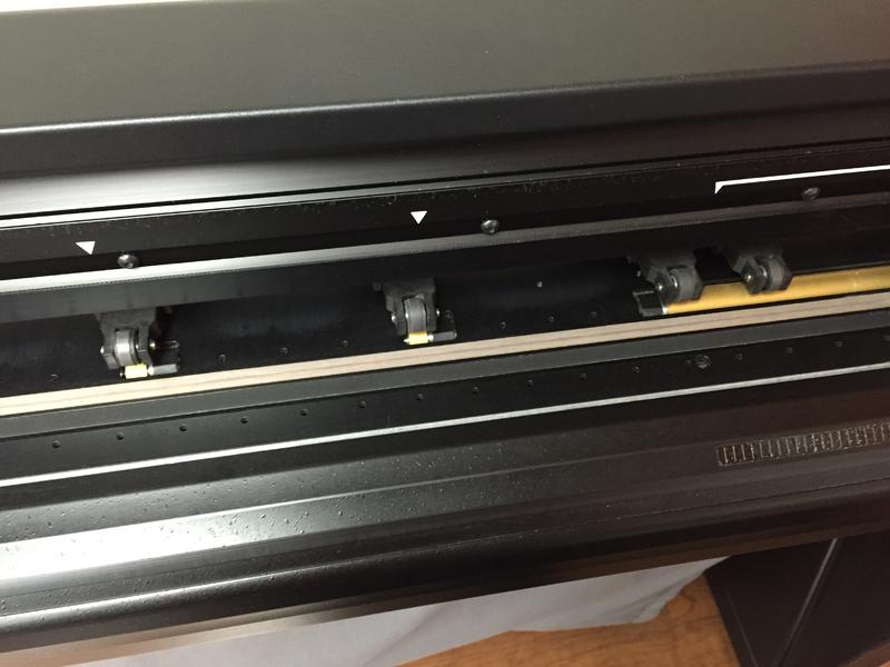

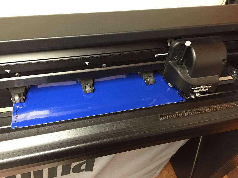

What am I missing? Summa S2 160, I just need to use 3 pinch rollers but I have to have all 4 locked in or else it gives me an error. This is messing with the size calculations telling me I have a larger cut area if I leave a roller off. I can't get 4 rollers 15 inch vinyl. Help?
My old shop had a Graphtec that had a standby area, this one doesn't have anything like that.
Asuma01
You have to use the outer rollers.
There is a little lever on the back for each roller that you can push down that raises it up.
All 4 rollers should be able to fit on 15" media.
Push all the rollers to the right side of the machine.
