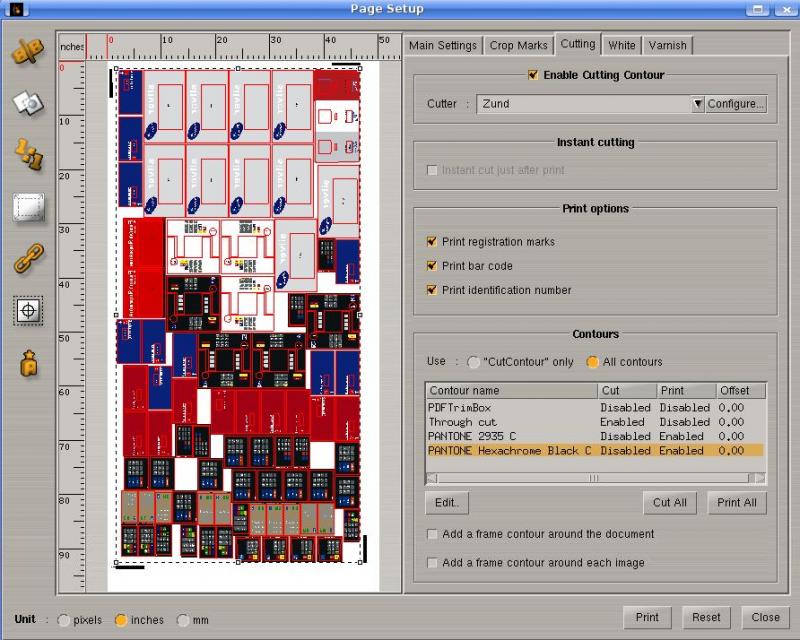

I am insterested in setting up a Summa S Class cutter driven by Caldera. What I need to know is how do I go about setting up Illustrator files to be nested in Caldera? I currently work with a Zund flatbed cutter and we name the paths with CMYK spot colors called "Through cut" and or "Kiss cut" and Caldera prints the registration along with a barcode and saves the cut paths to a designated storage space on our server. Is there a general guideline on how to setup a Caldera / Summa workflow? Below is a screenshot of nested parts to be cut on the Zund.
